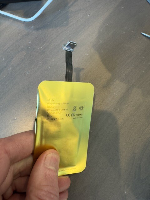

So I have a bunch of these cheap Qi charger adaptors i get off of amazon ( they come in USB-C , USB-A and Lightning versions). I’m currently have 5 wall mounted tablets using them. What i do is pull apart the Qi section, and solder that flat ribbon cable part to a regular USB cord, which i then connect to a low voltage power source behind the wall.
But @Craigers i do like the convenience of the ones you found on amazon, even if they are overpriced, if those were available when i mounted my tablets , i probably would have done that instead. Here’s a $15 dollar one i may try out at some point.
