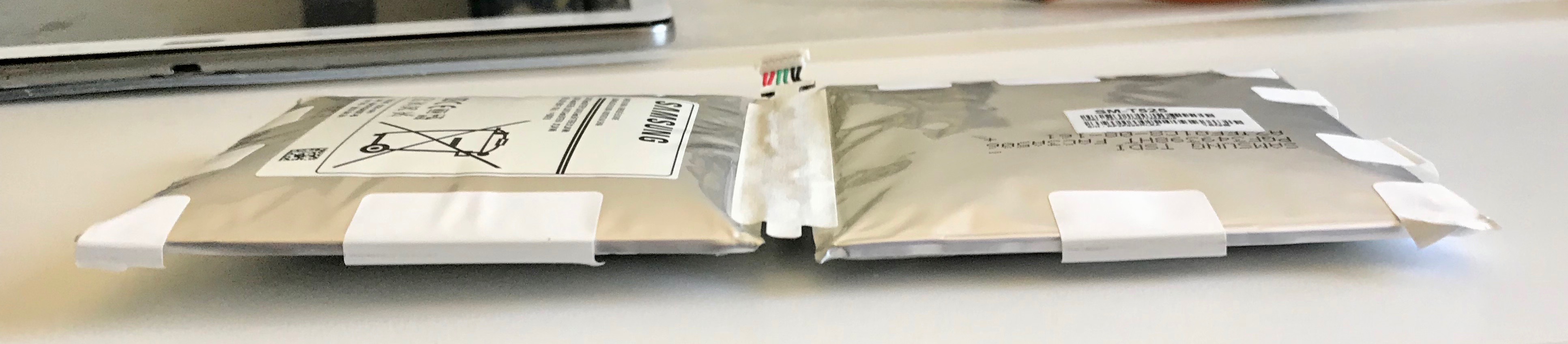

A story to share - after over a year of operation my wall tablet (Samsung T525 - pictures somewhere above in this thread) got swollen. The battery inside started swelling, I assume from the constant charging power attached. Initially I did not figure that out, just the bottom button dropped inside in the case and I thought it was kids that had broken it. But today the screen detached from the case and a gap appeared between the frame and the wall.

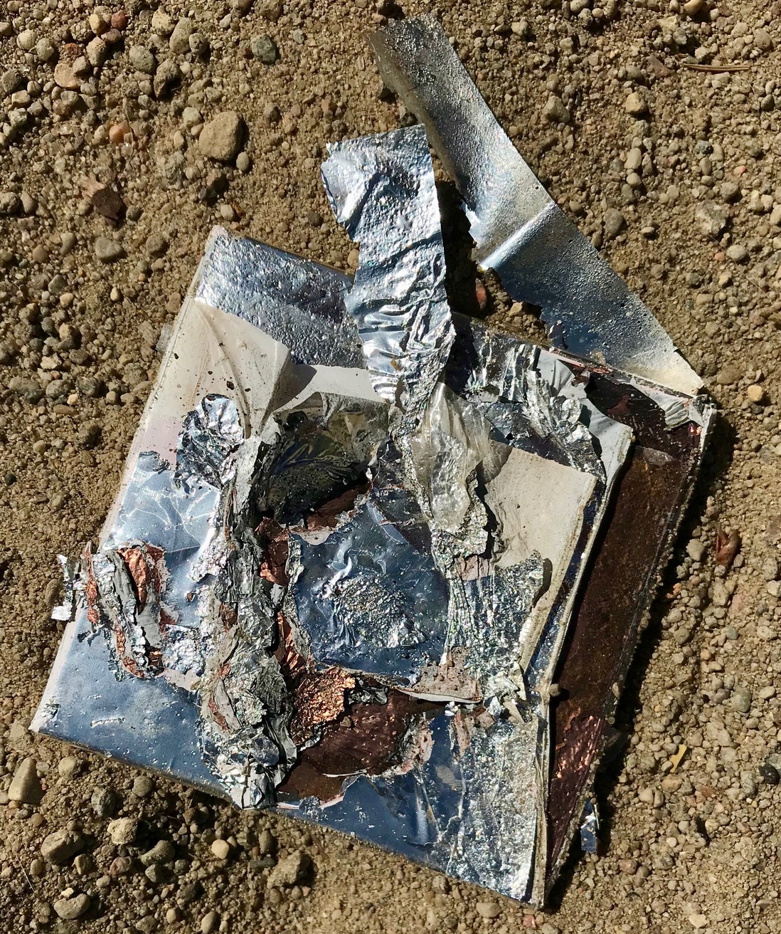

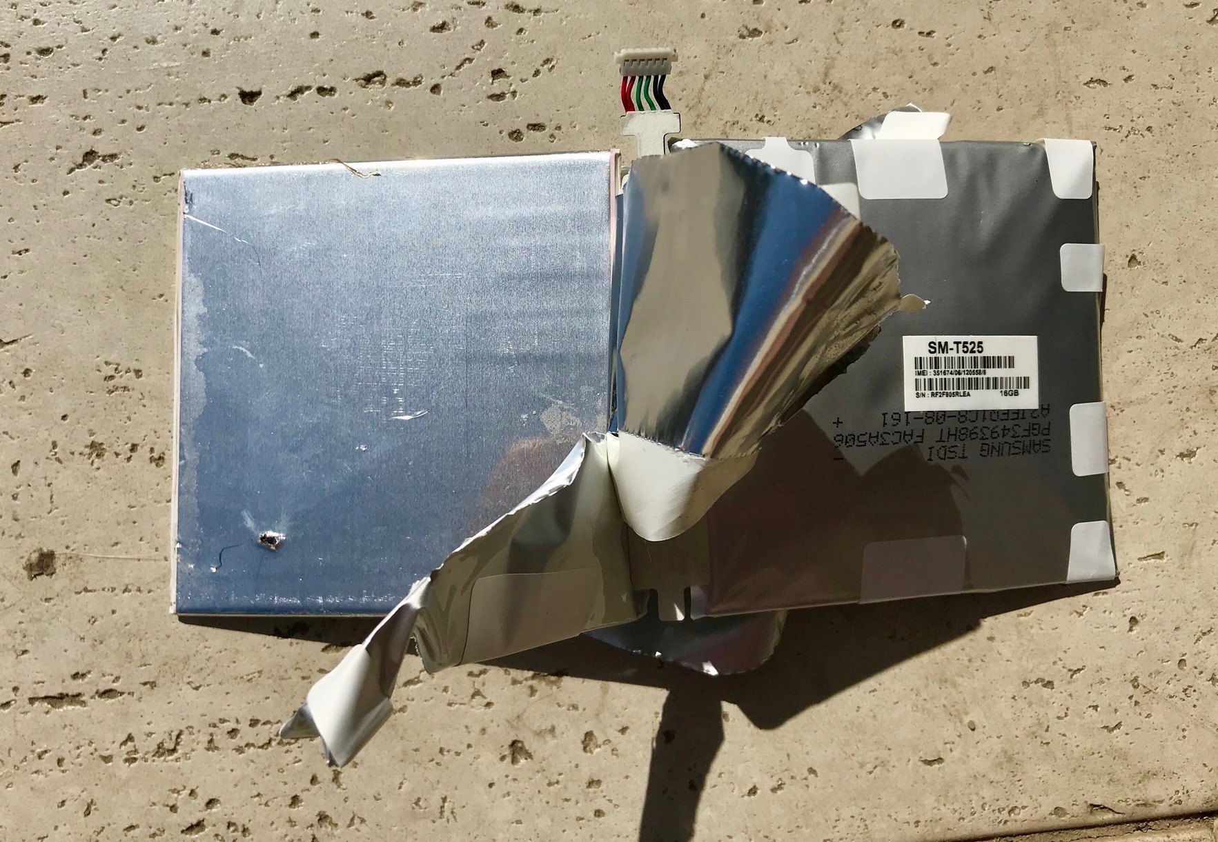

I removed the battery - for that I needed to take off the back cover. I detached the battery packs from a small electronic board with the connecting cable and kept the board. I must say I was curious what was inside the batteries and went outdoors to open them. Apart from a gas, the internal part of the battery seemed not malformed. However, a small damage to the surface caused the pack to get very heat and burn with smoke. I now have seen why these batteries are said to be very dangerous. I did not know how to dispose of the battery in such an excited state, so I tried to smash it and leave in a sand - I will see tomorrow if I can take it to the recycling safely. Not very wise, but once you started, there is no way back…

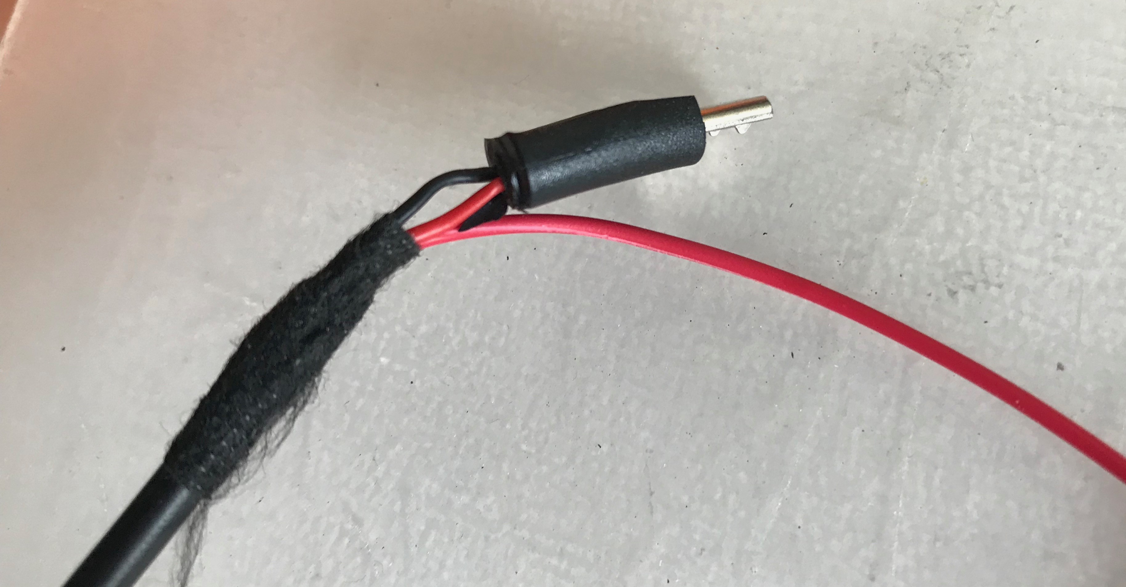

Then there was time to think how to make the tablet working again without the battery. First I connected the small board that was part of the battery - it contains a thermistor for measuring the temperature and an ID resistor to identify the battery. Without this board, the tablet will not power correctly even if supplying voltage directly to the battery terminals. With the board, connecting the tablet to an external power supply caused it to boot but it immediately shut down detecting battery is drained. Finally it worked when connected it to the charging power supply and at the same time connecting the positive charging terminal to the positive battery terminal (the ground is shared). Now it is working again.
