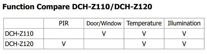

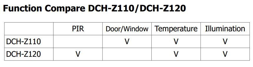

For the DLink DCH-Z110 we are setting the PIR Sensitivity from 0 to a value greater than 0, which is working fine. The change is also recognized as the movement is shown in my Database. But after some time (probably after wake up) the value is set again to 0 (which means deactivation of the PIR).
Check this post My first Door Sensor
I doubt that this is a binding issue then. The binding doesn’t do any device configuration (of configuration parameters I mean) during initialisation (and certainly not after a wakeup).
I would suggest resorting to the log - get the device configured so that it’s working, then seeing what and when things change…
The link you point to is for another device - are they the same, just rebadged?
I don’t think PIR works with the Z110, looks like some components are missing on the PCB.

I think the DLink DCH-Z110 does not support PIR. Maybe thats why Habmin resets the value back to 0?

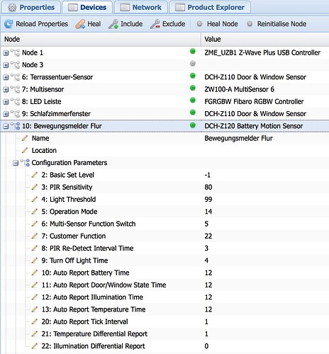

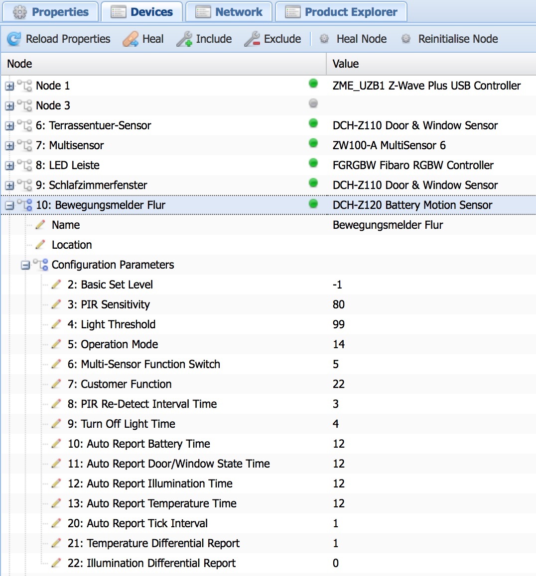

I have a D-Link DCH-Z120 and it doesn’t seem to work like described here.
I’ve created similar items for it (using OH 1.8.1) like I have for my three DCH-Z110 which are working fine:
/* D-Link Bewegungsmelder */ Contact DCH_BM_Motion "Bewegung Flur [%s]" <contact> (Flur) { zwave="10:command=SENSOR_BINARY,respond_to_basic=TRUE" } Number DCH_BM_Temperatur "Temperature [%.1f °C]" <temperature> (Flur, Charting) { zwave="10:command=sensor_multilevel,sensor_type=1" } Number DCH_BM_Helligkeit "Luminance [%.0f %%]" <sun> (Flur) { zwave="10:command=sensor_multilevel,sensor_type=3" } Number DCH_BM_Battery "Battery [%d %%]" (Flur) { zwave="10:command=battery" }
Its blinking when motion is detected but no update happens on the DCH_BM_Motion item.
The Configuration Settings must be the key I assume - I am using:
5: Operation Mode = 14 (I wanted 10 which seems to me correct, but when I enter it it applies automatically 14)
7: Customer Function = 22
Using these settings its still delivering the temperature in Fahrenheit and Motion alert is never triggered on the item - its always closed although the device is blinking when it recognizes movement.
Can somebody help me please? (Maybe other config parameters are important here which I am currently ignoring?)
Okay, problem solved - changed Operation Mode to 12 and restarted Openhab, then it worked.
