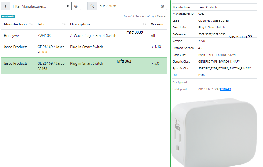

This one has a different manufacturer ID I think, so it’s not possible to just add the new device type unfortunately.
Well, looking in the OH GUI, it shows:
- zwave_manufacturer 99
which I think are all the other JASCO devices Manufacturer ID (HEX 063)
I think you had first looked at Honeywell.
But I have other versions of this same switch that are GE/Jasco.
They have this id as follows:

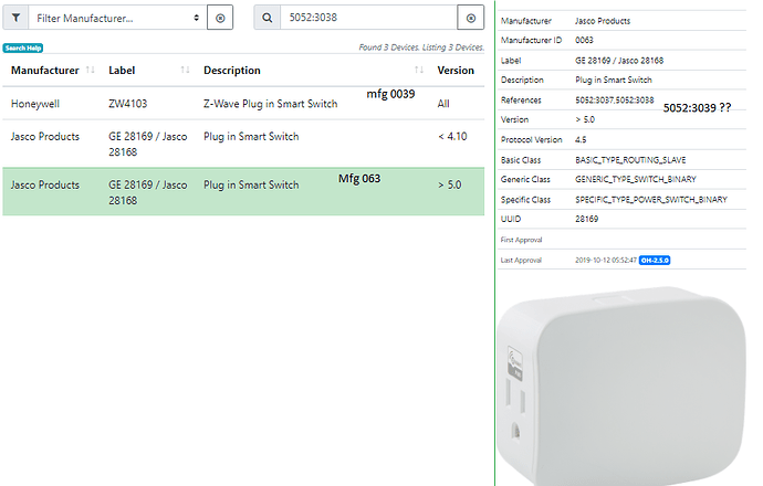

So I’m wondering if THIS device (above) can be referenced.
I’m just not sure where to put that REF. ```
5052:3038
Exactly - so the manufacturer is different - right?
You have the hasco - hex 63 - but the database reference for this device that I linked above is the honeywell - hex 39.
No - as I said earlier, you have a different manufacturer than what is in the database. Or maybe there is another entry for the ZW4103 that I didn’t find that is a Jasco version? At least you cannot just add your device type/id to the database entry I referenced above.
There are three devices with the same reference ID, two Jasco (063), One Honeywell (039) and appear to be the same (same picture, same parameter and same endpoints). Two versions also have the same association groups. What we do not know at this point is how they compare to the device @toddwevans possesses.
The device owned by @toddwevans needs to be compared to the existing devices and added in someway to the DB (either as additional reference IDs or as a new device), requiring @toddwevans to register, then open a ticket for write access. Then compare the parameters and endpoints. If adding reference numbers, the MFG need to be the same

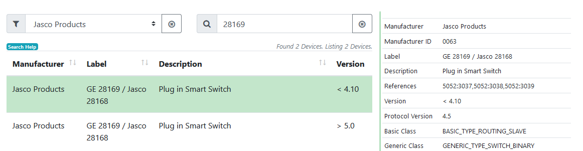

I WAS able to add an additional reference to: Jasco Products GE 28169, adding ,5052:3039 and saving. Will this cause any kind of conflict IF someone adds the information above for 4104?
I don’t want to mess anything up Thanks
Todd
There are two versions in the Z-Wave database:
IIUC your device is version 5.22, so you should add 5052:3039 to the device with ‘version > 5.0’ (and remove 5052:3039 from the device with ‘version < 4.10’).
Please do not forget to request a review.
AFAICT the binding identifies a Z-Wave device by:
- manufacturer ID
- References
- Version
The Z-Wave database should check for conflicts and refuse to add a new entry for the same IDs. I don’t know if this is implemented (and what happens if several DB entries match the IDs). I’m sure @chris knows the answer.

I removed from the old version and added to the >5.0 version and requested review on both.
