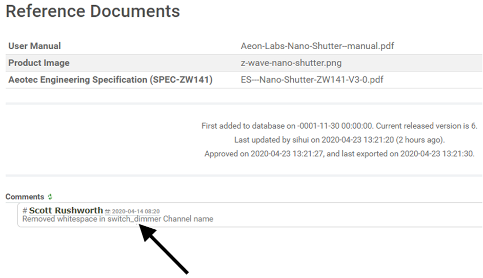

possible solution:
… corrected that entry in Chris’ ZWave device database
I see that entry was last updated this morning. That likely means we need to wait for the next database export. It usually occurs weekly unless @chris chooses to do it more often.
You would then need to manually install a snapshot binding after the build process picks up the changes.
Zigbee and Z-Wave manual install script - Tutorials & Examples - openHAB Community
Yes, but that was a different change. The original problem should be solved with updating to a current snapshot zwave binding.

Here you can find all the information about the device.
Please use a recent version from the past week as this issue was fixed a week or so back. The database exporter was updated to remove any whitespace that someone inadvertently added, so if this happens again, it shouldn’t manifest as an error in the binding.

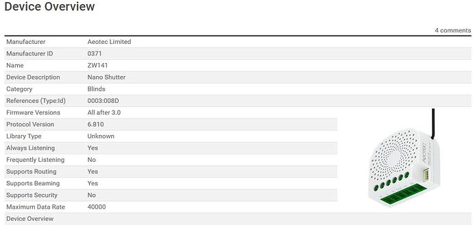

Thank you for pointing my to the database by Jackson: https://www.cd-jackson.com/inde
Now I´m totaly confused seeing in the database:
that zw141 is a shutter…
Remember I allready pointed out that the only aoen-device I ever had and have is the aeon-z-stick
So can anybody give me an explanaition why my openhabsystem try to contact a ZW141???
Regards and thanks
Stef
