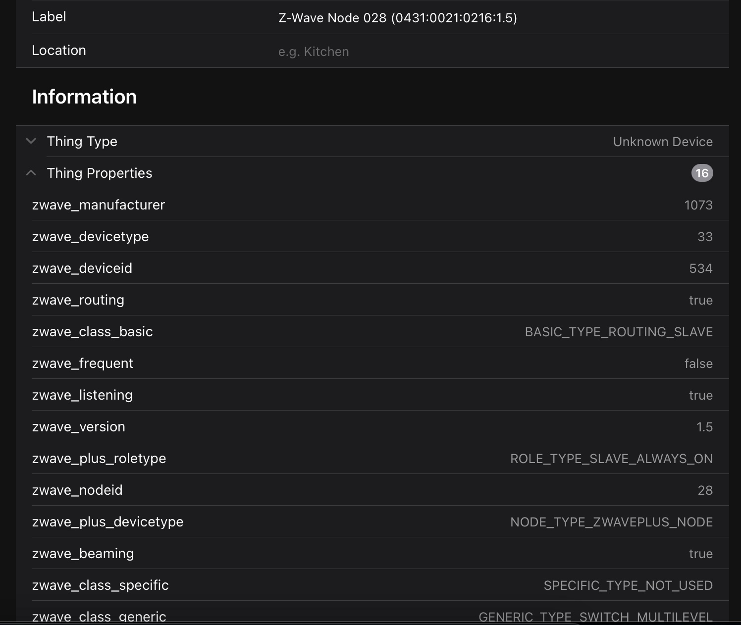

In Openhab, the device is listed as ‘Unknown Device’:

What am I missing? Do you have any suggestions as to where to look for the root-cause of the problem (or a solution :grinning:)?
There is a duplicate Unique ID with the two Ecobright devices, so only one (not yours) is in the binding. I added an “a” to yours and marked for review.
For a quick fix, you could add this file to your jar under the ecobright folder using this procedure, or some have been able to use a zip-like utility to add it.
ecodim07a_0_0.xml (8.9 KB)
Excellent! This makes sense, and I would not have thought of this myself. Thank you for taking the time, it’s truly appreciated.
I’ll try out a new snapshot in a few days time, when the z-wave database modification is accepted.
I’m not privy to the update schedule, but sometimes they are about a month apart.
BTW Welcome to OH. Good first post with plenty of details :grinning:
