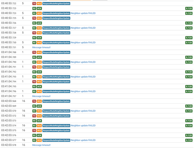

Hi everyone,
I recently migrated from OH2.4 stable to OH2.5 stable by installing a fresh system. When I plugged in my Z-Stick, I rediscovered all of my devices. Then I upgraded my binding to the 2.5.6-20200612.215243-7 snapshot using @5iver’s script to get support for a device which I contributed to the database.
Now, for some reason, many of my devices are reporting “Node not communicating with controller” though they seem to be working. I can switch them on/off through PaperUI or HABpanel, and they briefly show Online. Shortly afterwards, they go back to “Not communicating”. Likewise, if I manually switch them on, they report their state back to the system, then go back to “Not communicating”.
I have about 70 devices in a robust config, and roughly 25 of them are in this state at a given time. Many, but not all, are mains powered.
I’ve had DEBUG level logging on the zwave binding for the past few days. Looking through the logs using @chris’s log viewer, I see a lot of “Neighbor update failed” and “message timeout” messages.
Here’s a sample from the log itself:
2020-06-15 03:40:53.724 [DEBUG] [ab.binding.zwave.internal.protocol.ZWaveController] - Incoming Message: Message: class=RequestNodeNeighborUpdate[72], type=Request[0], dest=35, callback=83, payload=53 23

Going back in the logs, I see this around the time of the network heal:

I have a lot of log data. My system is set to heal at 2am. I’ve posted the attempted heal plus the next five minutes on pastebin, but have a lot more available.
Does anybody have any thoughts on what might be happening, or any ideas what would cause this? I see the neighbor update on node1 fails, which makes me wonder if maybe it’s a controller problem?
