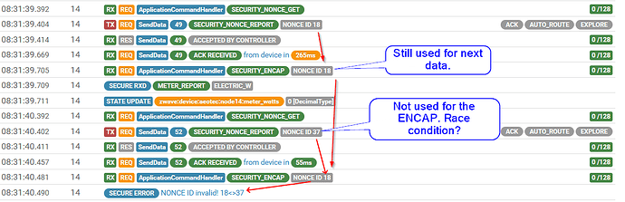

Today I had this issue also multiple times. It looks like the old nonce is used multiple times. However, in the last invalid message the nonce (94) is not even in the logs.
Maybe I got a clue, why this is happening.
I believe, that we have some kind of race condition here.
08:31:39.392 Device is asking for new nonce.
08:31:39.404 Controller is sending nonce 18.
08:31:39.705 Device uses nonce 18.
08:31:40.392 Device is asking for new nonce.
08:31:40.402 Controller is sending nonce 37
08:31:40.481 I believe that the new nonce (37) is not being received by the device, so it’s still using the old one (18)
Problem: Controller doesn’t accept the old nonce anymore. → Data lost.
Could somebody confirm this? What can be done against this issue (besides not using encryption)?

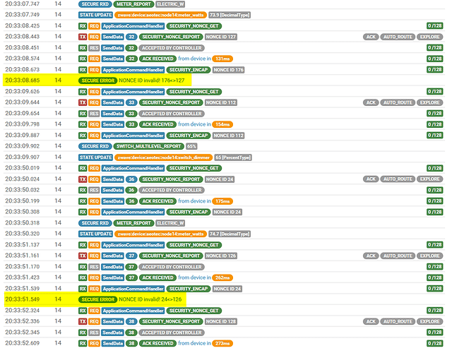

Hi there,
another issue I found today (does happen only sometimes).

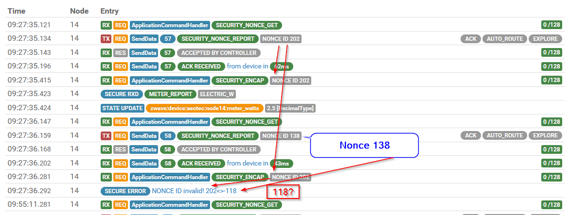

The invalid nonce message contains unknown nonces - where are they from?
Logfile:
nonce_invalid_20200204.txt (20.5 KB)

The issue here is duplicate frames. The same frame is received twice and that consumes the nonce. When the second packet is received, you get the error. Probably I should add more duplicate packet checks to resolve this.

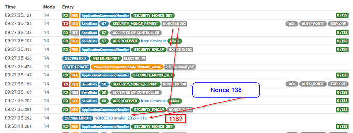

Could you tell me, where in the logs you found the duplicate frame? I’m still trying to fully understand all the log entries. Thank you.
Yes, looking further it’s not a duplicate frame - it just looks like the device sends two frames using the same nonce. I’m not sure why that is, but it seems to be a device problem as far as I can see. The binding sends a second nonce (0x8A) byte the device sends another frame using the same 202 nonce.
Just to note that some of your confusion here might be due to the fact that the logging is confusing - it says the nonce is -118, which is correct, but it’s printed as a signed number since the binding uses bytes internally. -118 is really 138 in unsigned which is how the logger presents it.
defective device?
It’s unlikely it’s defective as such, but it depends on your definition of defective. It looks to me like a software bug as the device should not use the nonce twice, and that seems to be what it’s doing unless I’m missing something.

It doesn’t look like it to me. Firstly, if it’s a race condition, why is the device clearly using the same nonce for two commands? That should never happen. If the device has used the nonce, it should not send another request until it receives a new nonce.
It then receives the new nonce - the command is acked by the device, and then 80ms later the binding receives the new command using the original nonce.
