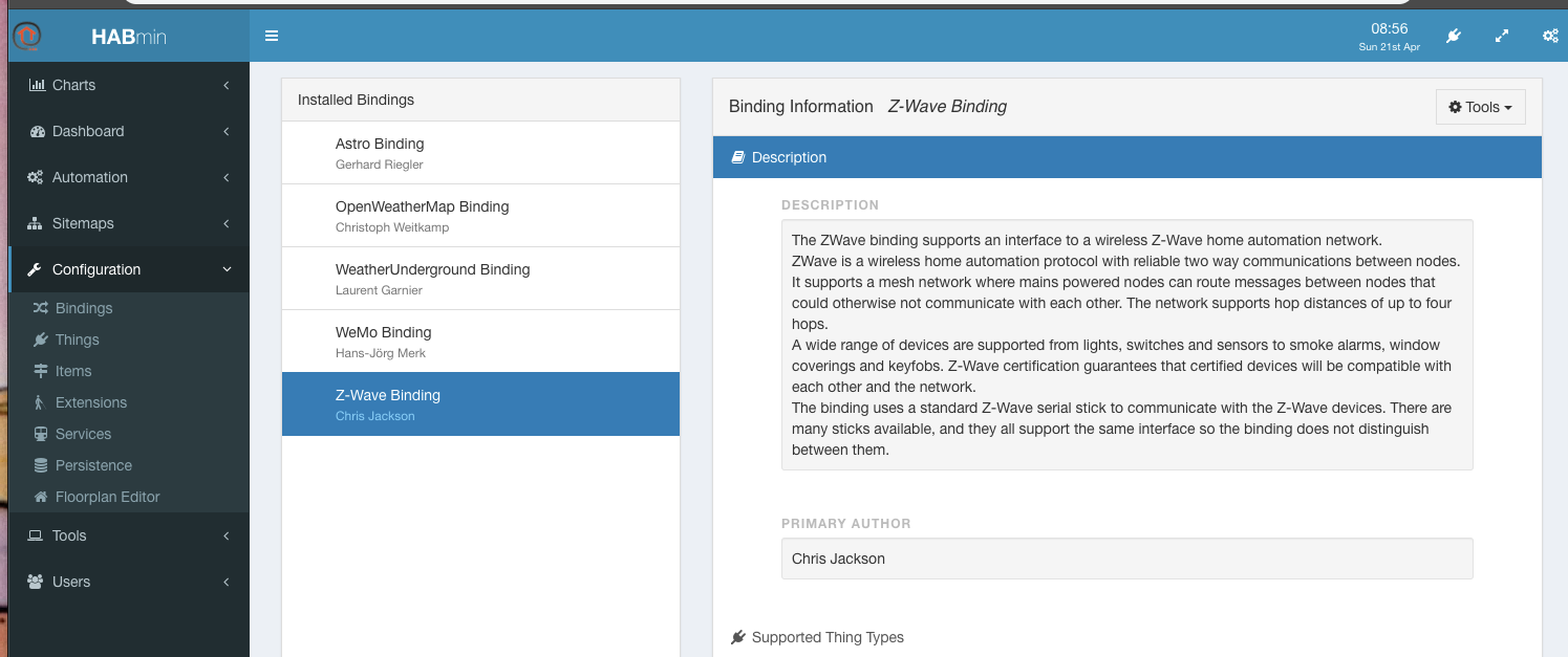

But I can’t figure out exactly how that is done. In Habmin, I see the “Installed Bindings” and clicking on this shows me the binding details with no options for any sort of inclusion, secure or otherwise.
The Z-wave controller likewise has no options for inclusion.

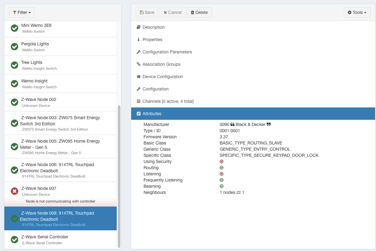

This is my current Thing that is not securely included:

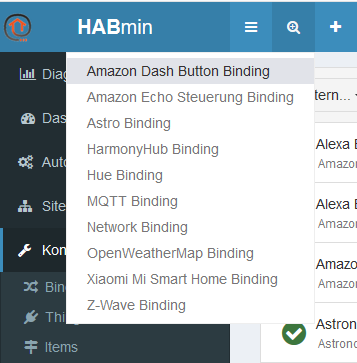

In HABmin on the Things tab click on the plus sign with the circle and choose “Zwave Binding”, this starts the inclusion process through the binding:
It is the exactly the same as every other binding :slight_smile: .

But now I have a problem. I deleted the deadbolt Thing from Habmin, then pulled the stick out and walked it over to the deadbolt and put them into exclusion mode, and everything blinked ok (I think). But when I insert the stick back into the OpenHab server and hit the plus sign with the circle, the deadbolt shows up as a thing again.
Am I going to have to factory reset the stick or the deadbolt?

So a plain delete from openhab will just delete the local thing but it will still be associated with the stick, and hence get picked up again in the inbox. In order to remove it from the controller, you need to choose advanced settings > remove device from controller, then delete from openhab. You might need to hard reset the device to get it back to inclusion mode.
