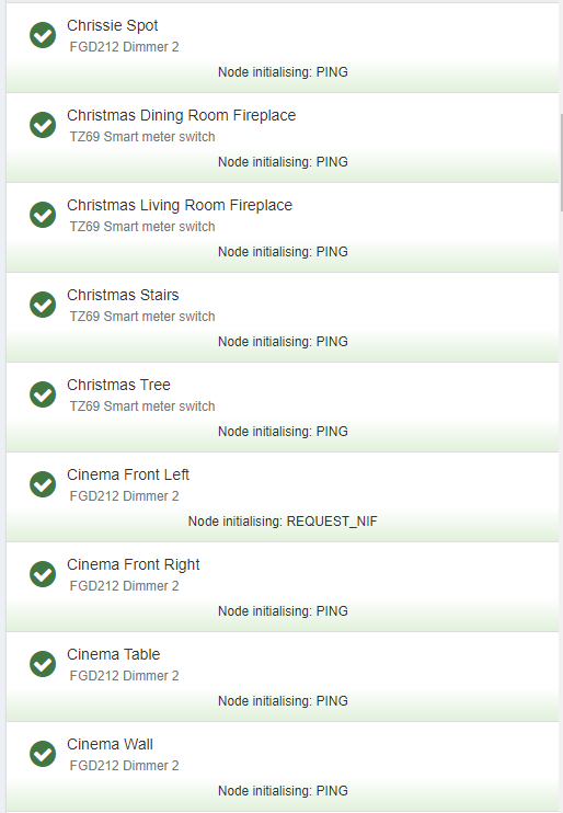

I had what seems like a similar issue… my symptoms were:
- Z-Wave devices sporadically work
- Z-Wave devices are in PING/REQUEST_NIF for hours after restarting the binding
- Z-Stick G5 color stops changing and stick stops responding
- Z-Stick seems to start working after some period of time and nodes work for a bit until the stick “freezes” again
