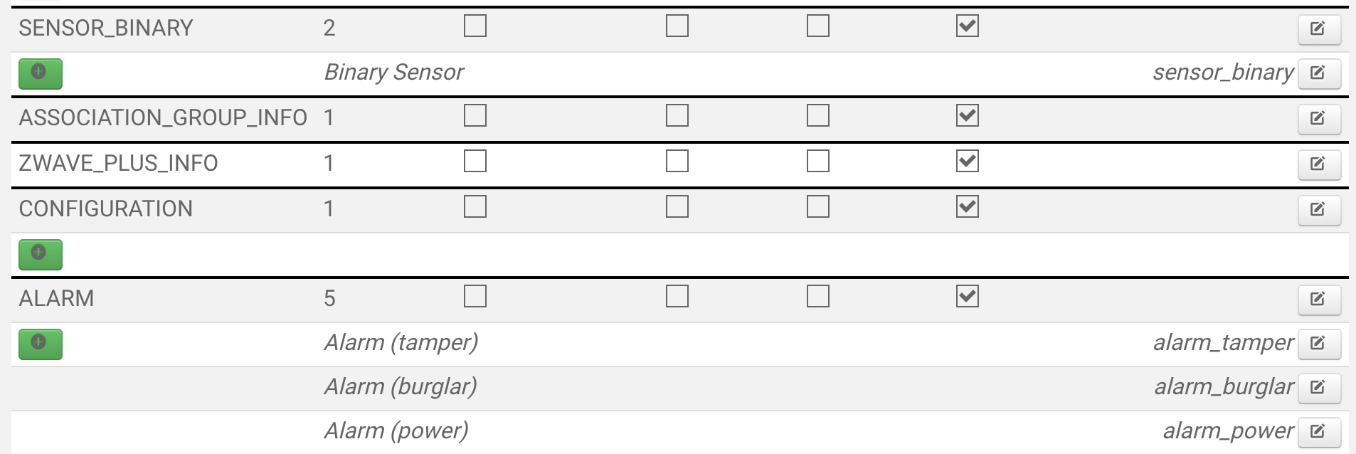

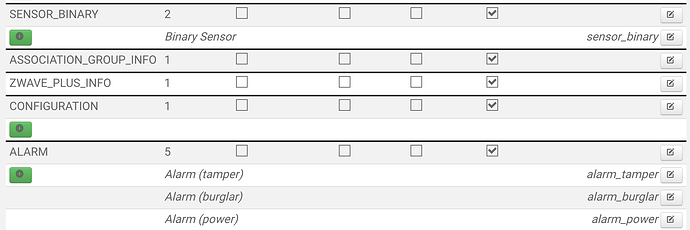

For this device, we probably should deprecate the binary_sensor channel and use the notification channels -:

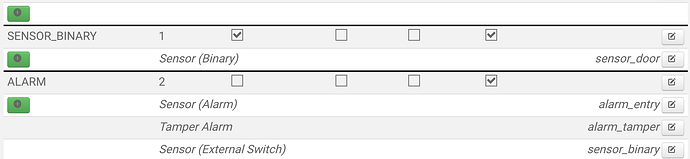

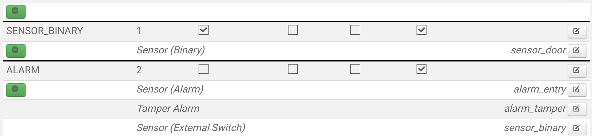

Likewise here -:
The channels should be updated so that they properly support the notifications.

What I would propose for both devices is to change the SENSOR_BINARY class to use sensor_binary channel, and then use the sensor_door and alarm_tamper on the two notifications. This would make these devices more standard.
FTR, I modeled the DWZWAVE25 after the DWZWAVE2, since they are very close functionally.
The DWZWAVE25 already has sensor_binary for the SENSOR_BINARY CC, so that’s ok. And, it already has alarm_tamper.
So, for the DWZWAVE25, you would change alarm_burglar to sensor_door?
Yes - my point was to make the two the same, but I wasn’t so clear…
Yes - I don’t think alarm_burglar will do anything at all in 2.4 with this device. This channel is linked to the intrusion notifications and not the door sensor notifications.
