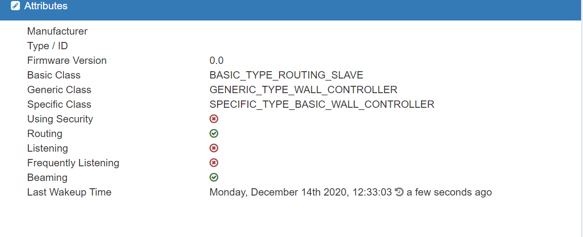

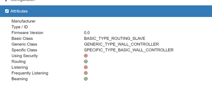

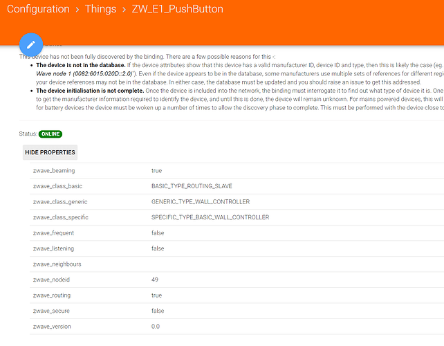

Hi Chris.
I’m unsure how to provide you this information.
I have uploaded screenshot of habmin and paperui.
But I assume this will not give you the information you need?
Ok I will wait and see if it will be completed.
I have also tried to reboot but currently it’s the same problem.
I also checked \var\lib\openhab2\zwave\ and I can’t see that the xml is generated for that device (yet).
Ok, unfortunately I can’t really say much more. Is the device waking up? My guess is that it isn’t based on the screenshots above. Maybe its too far away from the controller, or maybe the button press is incorrect.
Have you checked the debug logs to see what is happening?
Is that caused by the wakeup, or something else? Have you enabled debug logging? If not, please read the binding docs and do this - otherwise we can just guess, and that’s not very reliable
Really, we need to understand this as it’s important. If the binding doesn’t receive the wakeup message, then it won’t be able to initialise the device.
