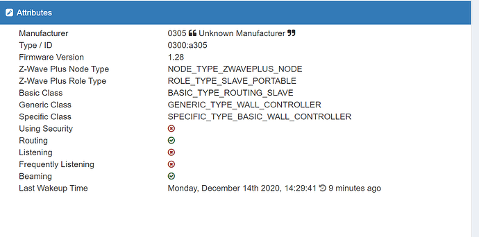

I meant like you posted earlier but only if Type/ID hac values other than 0.

Please see the uploaded picture
Great - so it should now be correctly discovered, and working?
This is the same as in the database, so it should now be discovered correctly? (or is it still not working :roll_eyes:)
Still same issue :slightly_frowning_face:
Is mine different manufacturer?
Compare with the first post?
So the log you provided does not look like it is from the initialisation. It only shows the wakeup, and it looks the same - the device does not respond.
However, given that the XML was created, and the manufacturer information is known, the binding has in the past managed to communicate and it must now be identified (since all the identification information is there!).
I’m not really sure I can help much more :frowning:
:+1:
Yes, well spotted - it’s not the thermofloor device. You will need to add this to the database.
