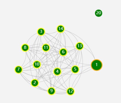

What I find a bit strange is that in the OH Z-Wave network map it is shown (#20), but somehow outside the network
