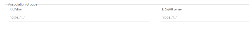

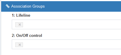

Just for example the associations of one of my Z-Wave thermostats with Habmin:
and the same device shown with PaperUI:
So PaperUI is showing things correctly.
This is really a pity that Habmin is not displaying this information reliably.

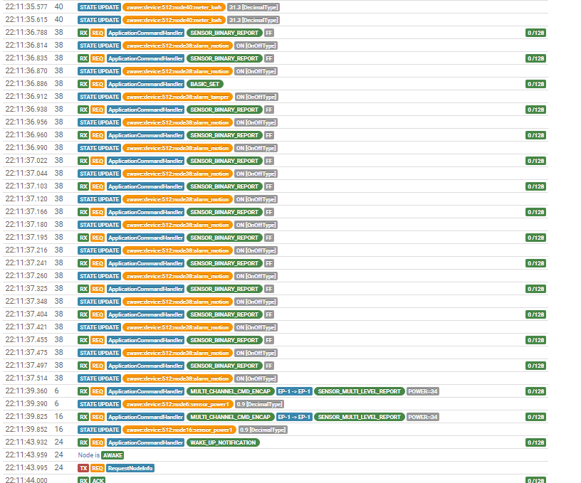

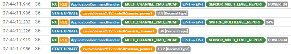

Okay, so the lights started reporting when I switched. But my battery devices are behaving strange. Like this one (last part of the log) that is reporting its state multiple times and another which has its lifeline set, but is not reporting.

I had a look at the log, but there’s a lot in there, and I’m not really sure what you want to look at. If by the “last part of the log” you mean this -:
I don’t know that this is really duplication - the two meter reports are received 5 seconds apart - if messages are duplicated, they tend to be received very close together. This might also be caused by the way you have configured the device.

As for the log I was thinking about what is going on with node38:
The only time I’ve seen this sort of multiple repetition is if the device has an issue and normally resetting it will fix it. That said, if you have multiple association groups set, this can also cause duplication (but here by duplication, I mean 2 messages - not ~10!). I suspect some of this will be related to the multiple associations as there are different messages being sent here as well and probably this would not happen if only the lifeline is used as it normally will not send the BASIC commands.
