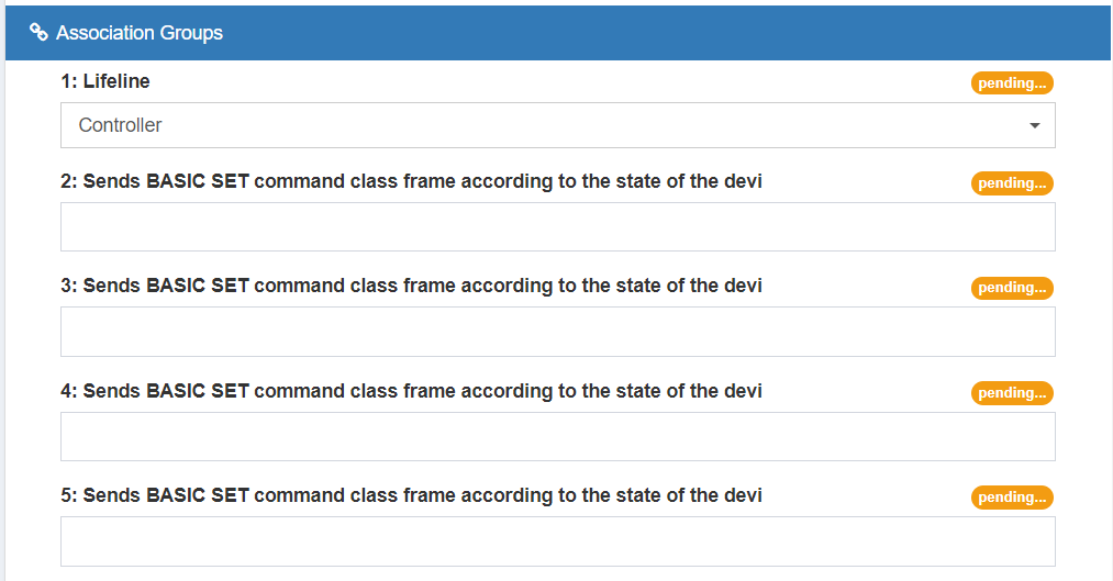

When I try to set the association group the things get “pending…” status in habmin. In paperUI everything looks alright until I restart the service or disconnect the controller (not sure which). Then they return to null again.
Here is a log file from when trying to first update one node (#45) in paperUI, thereafter in habmin (node #39) with controller added.
In info log it only reads things like “configStatusMessages=[ConfigStatusMessage [parameterName=config_52_2, type=PENDING, messageKey=null, arguments=null, message=null, statusCode=null” for all parameters.
I have tried most things I believe and am pretty stuck. Any tips appreciated!

For the PENDING messages, if this is node 39, then I guess that this is a battery device since I see nothing in the log at all for this device. If so, the pending messages are normal - the configuration will stay like this until the battery device wakes up an the data can be transferred. Pending is removed after the binding receives the next report of the configuration state.

Unfortunately not. At least, the updates that you made did not generate these commands - they must have been generated earlier and were already in the queue (there were 49 messages already queued when this log started). At least this shows that the binding would not have removed the association as a result of this update, but something DID remove the association, but it’s not in this part of the log.
If you mean node 39, there are no messages at all logged for this node. It may just be that with the queue length, the log doesn’t yet have these commands in them. I do see the commands from the UI, but within this log, nothing actually gets sent to the device.
Note that “commands” like turning on and off a light are considered high priority and will go straight to the top of the queue. Configuration is considered low priority and will be sent when there are no higher priority commands to send.

The log shows me trying to add association groups (both node 45 and 39, and both are non-battery-devices). For these two nodes the association group got lost at some point when switching to 2.4 and I haven’t been able to add association groups since.
I am running openhabianpi an rPi 3, latest snapshot.
That’s understood, but the log doesn’t have all the information in it as the logs are not complete. By this I mean there was a lot that happened before the log starts, and the queue already has some stuff in it.
The log shows that for node 42, the controller is set, but sometime before the log starts, something has queued a message to remove this, but due to prioritisation, this command is not sent for quite a long time. I would like to see what created this message, but unfortunately it’s not in the log, so I’ve no way to know where this was generated.
If you don’t have the full log, then unfortunately I can’t work out why this is happening…
