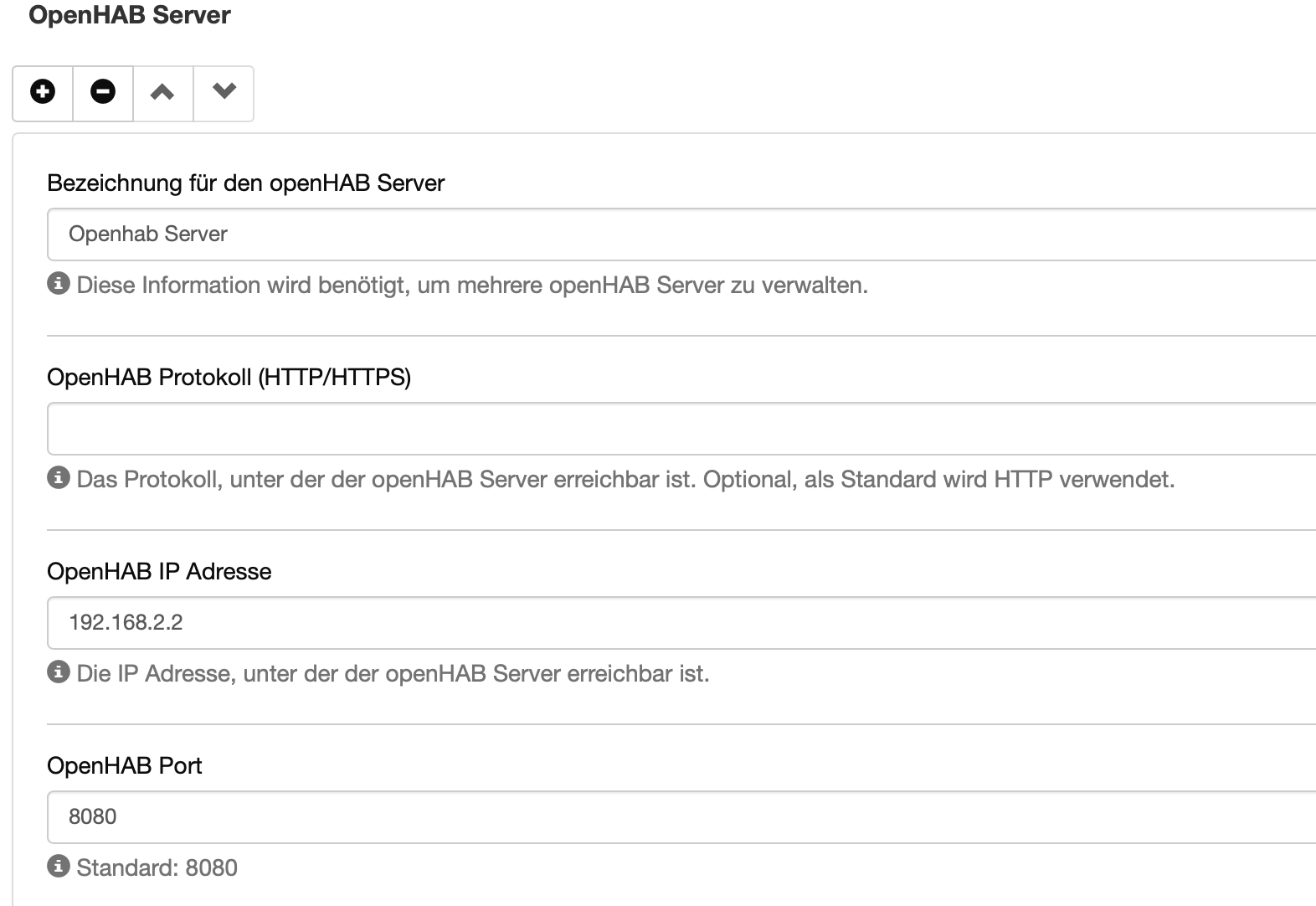

The OpenHab Connector in ZWay is configured:

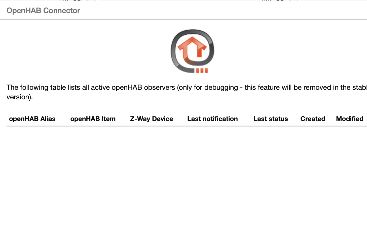

The Observer in ZWay does not have entries, maybe this is the problem:
So it looks like updates in Zway are not communicated to OpenHab.
