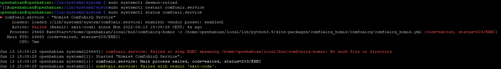

Hi cmachtel
Can you please post your full working entry for Systemd.
My entry, which ends in en error:
[Unit]
Description=“Homie4 ComfoAirQ Service”
After=syslog.target network.target mosquitto.service openhab.service
[Service]
WorkingDirectory=/home/openhabian/.local/lib/python3.9/site-packages/comfoairq_homie/
Environment=COMFOAIRQ_LOGLEVEL=INFO
Environment=COMFOAIRQ_COMFOCONNECT_LOGLEVEL=INFO
Environment=PATH=/home/openhabian/.local/bin:$PATH
ExecStart=/home/openhabian/.local/bin/comfoairq-homie -c /home/openhabian/.local/lib/python3.9/site-packages/comfoairq_homie/comfoairq/comfoairq_homie.yml
[Install]
WantedBy=multi-user.target
Error Text:
The “ExecStart” works perfect in the command line.
Any Idea? thanks for your help.
For me this works:
[Unit]
After=syslog.target network.target mosquitto.service openhab2.service
[Service]
WorkingDirectory= /home/openhabian/.local/lib/python3.7/site-packages/comfoairq_homie
Environment=PATH=/opt/comfoairq/virtualenv/bin:$PATH
ExecStart= /home/openhabian/.local/bin/comfoairq-homie -c /home/openhabian/.local/lib/python3.7/site-packages/comfoairq_homie/comfoairq_homie.yml
Restart=always
[Install]
