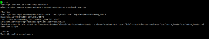

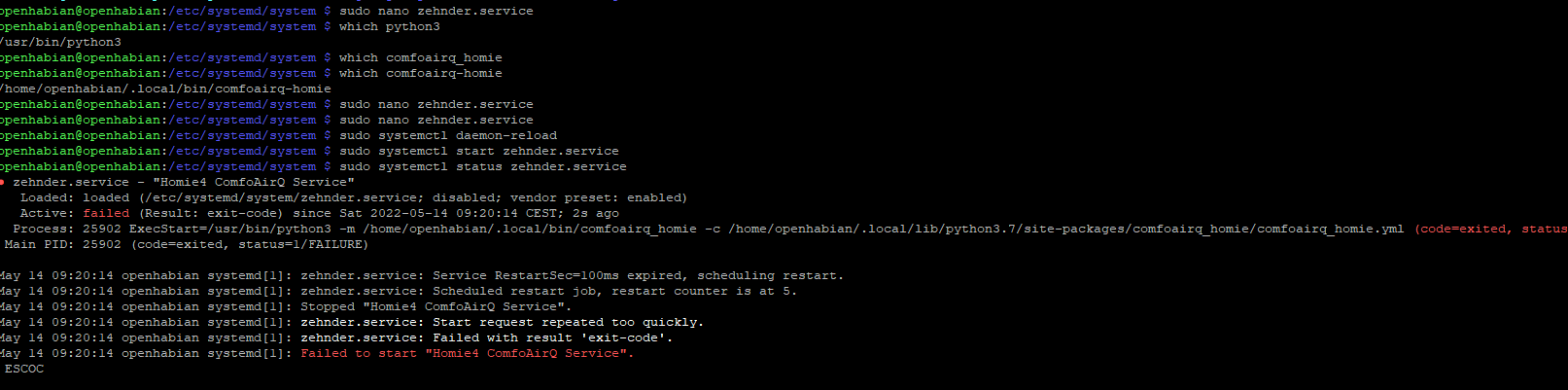

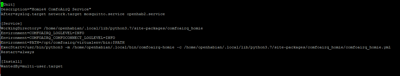

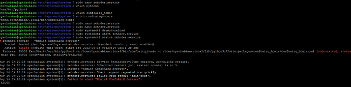

Thank you @klaudiusz223 , this helps a little but still not working. I now have
which comfoairq_homie did not work but which comfoairq-homie works
My file currently looks like this. But tried the comfoairq-homie and with _
Thanks for the support
@cmachtel
Remove “/usr/bin/python3 -m” from ExecStart.
Do not mix 2 different ways of running python script into one.
Besides, check that the command you put into ExecStart works from the command line. If not, it is unlikely to work as a service.
Please do not send screnshots with the configuration because they are bulky. It’s much better if you send them as a text.
