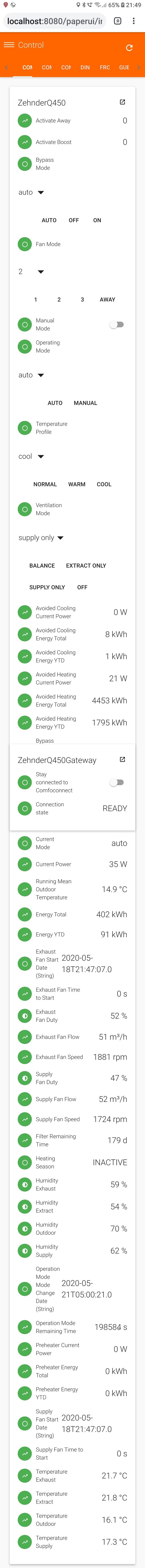

Completely new to this topic yesterday I setup a VM (ubuntu 18.4) and set up openhab, mosquitto and even Klaudiusz scripts / brokers / items and what all :slight_smile:
My first goal was to read values from the device. Cause Paper UI is annoying I set up basic UI, items and a sitemap. WOW, I can read the values :slight_smile:
Now my goal is to set values and here are the questions:
The away Mode is read in seconds. The app asks for a end date. Will there be a good and comfortable way to set it up to transmit an end-date? With some switches I now set up Buttons like “+1 Week” “+1 day” “+1 Month”. With a rule it works :slight_smile:
The bypass is controllable manually but the standard time is ever set to 60 minutes and the value is not changeable. In the app I can set 1-24h. Is it correct, that writing this time is actually not working? Or did someone got it managed?

Zehnder|509x500
The easiest solution is to use setpoint in the sitemap. You don’t need to use rules but in one element You can have only one time period ( i.g. 1h, 1day, 1week). There is no simple date time picker in OpenHAB. Custom widget is needed. Maybe You can search the forum to find suitable solution.
Check new version in the repo. I implemented this feature adding two additional controls. There is also an example of the sitemap.
Thank you, it is working great. Setpoints are enough for me :slightly_smiling_face:

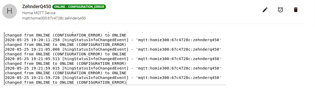

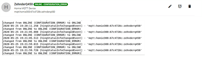

First thanks to everyone for the great work !
I have configured everything and see my Zehnder Q450 in Openhab.
Problem is that it is switching between “online” and “online configuration error” in openhab.
Does anyone know this problem or does someone know what to check ?
Thanks!
Problem solved, i used the wrong PIN.
It is not the PIN of your Zehnder Q (installer password), but the PIN which you configured when installing the comfoconnect box !
