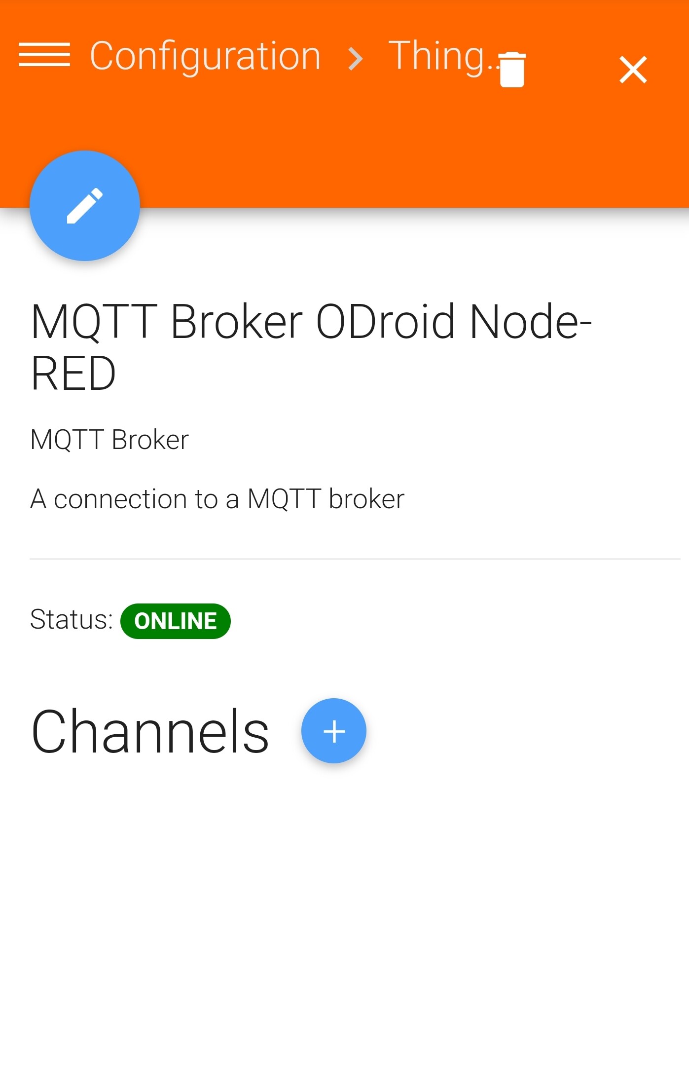

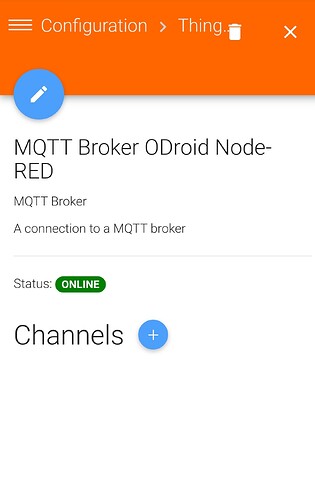

Would this Node-RED MQTT Broker be suitable?

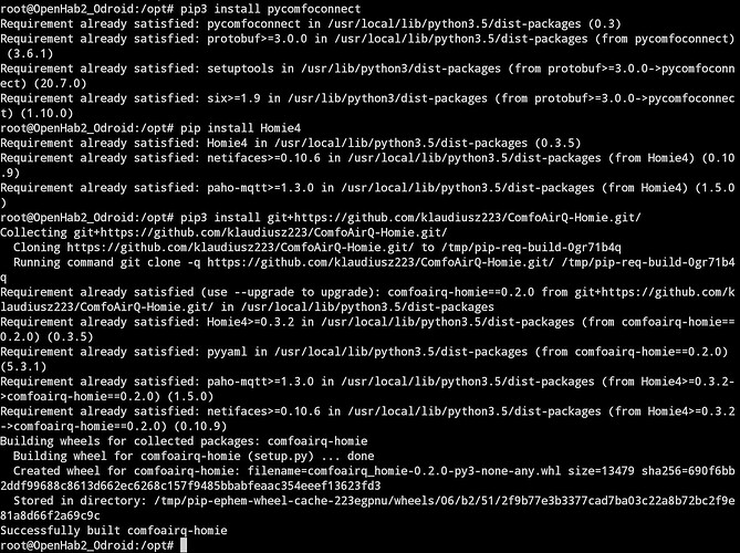

Can you shed any light on this?

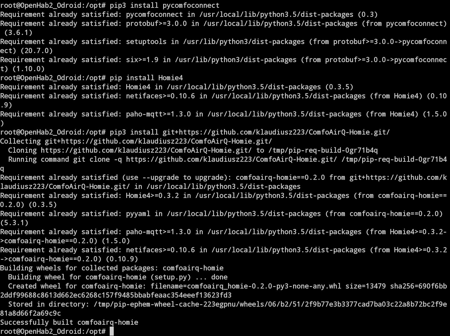

I’ve added the two items that you mention on your GitHub page (and Wheel, which was missing)
But when I run the comfoairq-homie command, I get this

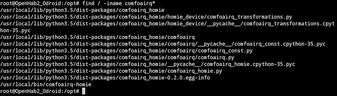

I’m assuming I’m missing a step somewhere, as I would assume I need to put add an IP address and some credentials for both the ComfoAir and the MQTT broker ??
Also, will this run in the background without further interaction and how would you recommend I / we add it to the startup routine?

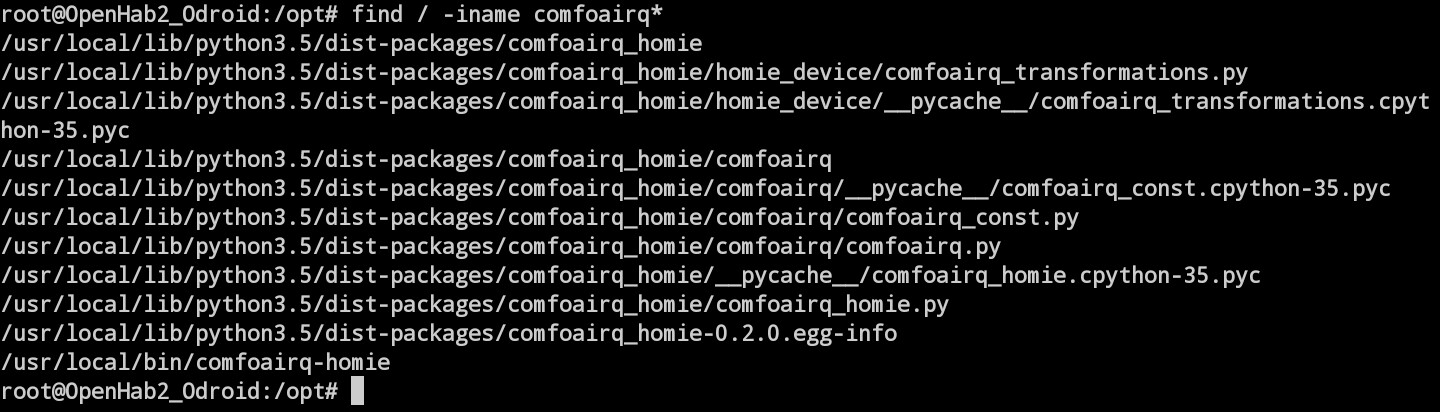

Update
It looks like I’m missing a step somewhere, as the comfoairq-homie.service file hasn’t been installed
And FYI
It looks like it’s due to python 3.5. Theoretically python 3.6 is required but I will try to solve it. Please check the new version I recently commited (use --upgrade option during installation). I updated also README file and added info about config file. Systemd service file is not installed by default. You need to do it manually. Example configs are in repo.

I’m hoping that this comfoairq-homie.service file will do the trick, once I get the PIN right.
[Unit]
Description="Homie4 ComfoAirQ Service"
After=syslog.target network.target nodered.service openhab2.service
[Service]
WorkingDirectory=/opt/ComfoAirQ-Homie/
Environment=COMFOAIRQ_LOGLEVEL=INFO
Environment=COMFOAIRQ_COMFOCONNECT_LOGLEVEL=INFO
Environment=PATH=/opt/ComfoAirQ-Homie:$PATH
ExecStart=/usr/bin/python3 -m comfoairq_homie -c /opt/ComfoAirQ-Homie/comfoairq_homie.yml
ExecStop=/bin/kill $MAINPID
Restart=always
[Install]
WantedBy=multi-user.target
Update

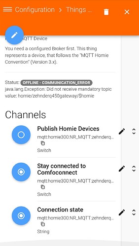

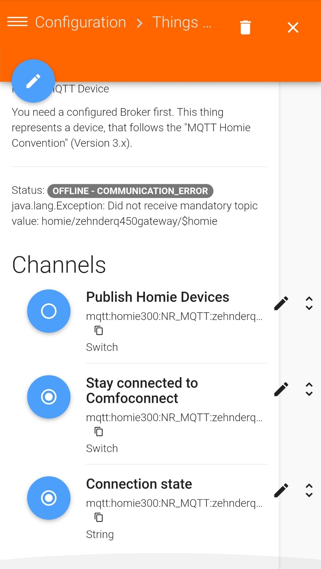

We’ve got the pin now and the output has changed to something more positive, but it still looks like there is an issue, as PaperUI is reporting this for the Gateway Thing
Status: OFFLINE - COMMUNICATION_ERROR java.lang.Exception: Did not receive mandatory topic value: homie/zehnderq450gateway/$name

I have upgraded to Python 3.6 using these instructions -
That’s is one of the issues I mentioned earlier. It’s a known bug ([mqtt.homie] Did not receive mandatory topic value: homie/xxx/$name · Issue #7252 · openhab/openhab-addons · GitHub). After installation any Homie device in OH you need restart it :-(. So please restart ComfoAirQ-Homie. Similar situation is when you restart OH. You need to restart Homie device. But I prepare workarounds. Rules for OH are in repo. So implementing this rules should solve future problems.
Regarding to config:
COMFOCONNECT_PIN : 0
is a correct configuration. You don’t need to change anything. I don’t know what for is this pin used:-).
Regarding to service.file
looks quite good but You need to follow the whole installation procedure for custom systemd service. Please find proper howto for Your linux distro. It will be much better than my;-)
Regarding to virtualenv folder:
My installation is in python virtual environment. It’s not necessary. It gives some advantages but You can skip it or leave it as last stage.

And the Things are stating
Status: OFFLINE - COMMUNICATION_ERROR java.lang.Exception: Did not receive mandatory topic value: homie/zehnderq450gateway/$homie
But… I have now got channels in the Gateway :smile: so that’s a massive step forward.
I’m totally stabbing in the dark here…

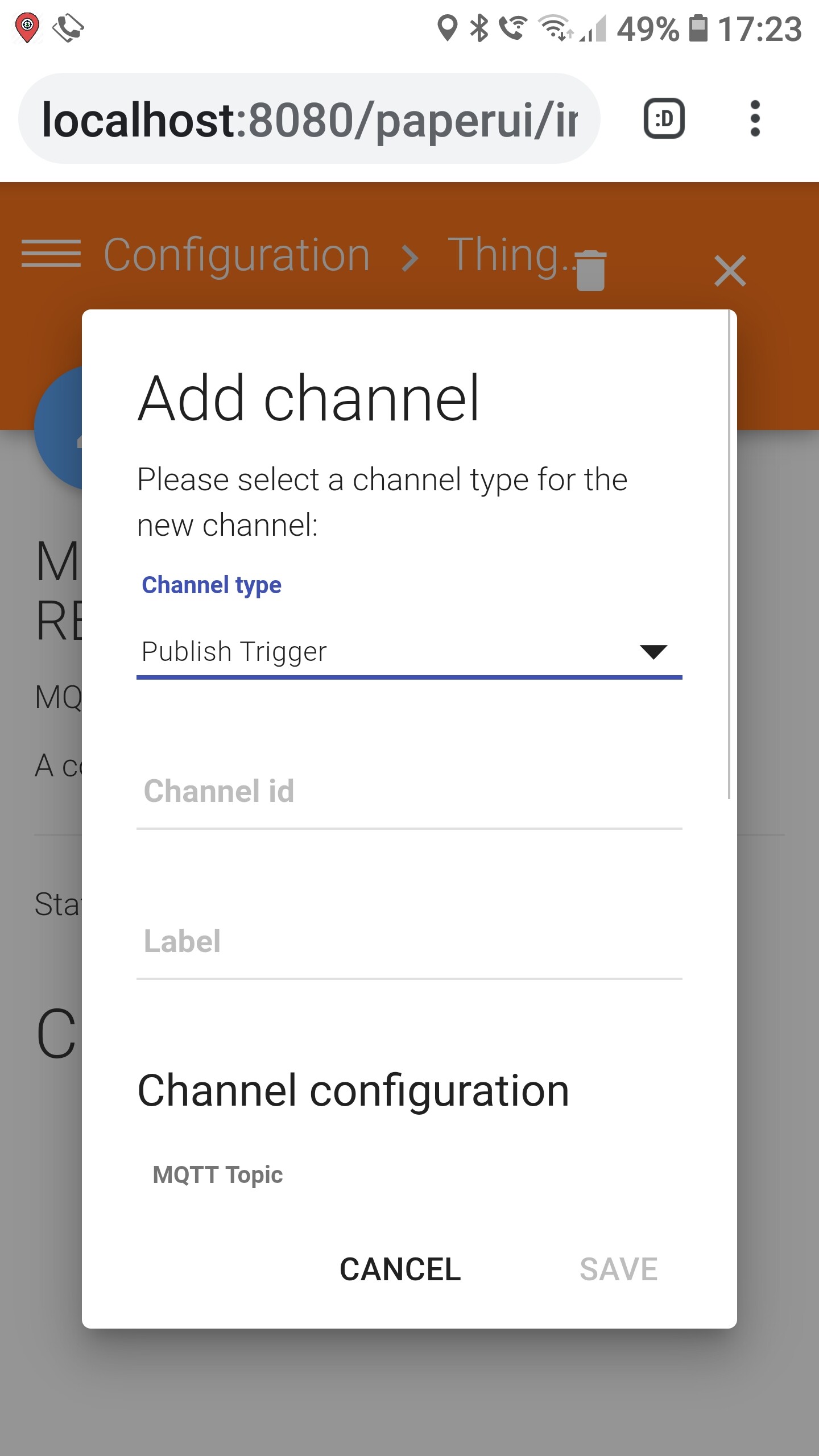

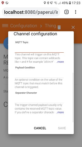

Do I need to do something with the MQTT bridge, like adding a channel?
If so .
What does it need?
