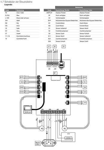

The Zehnder diagram shows a RF45 but does not describe a serial port, which the OH binding is looking for.

I did not buy any controllers, as I wanted OH to drive it… but I do not see a RS232 port on this machine… or more so the manual.
Maybe I buy the KNX module, then I assume the KNX binding can drive it.

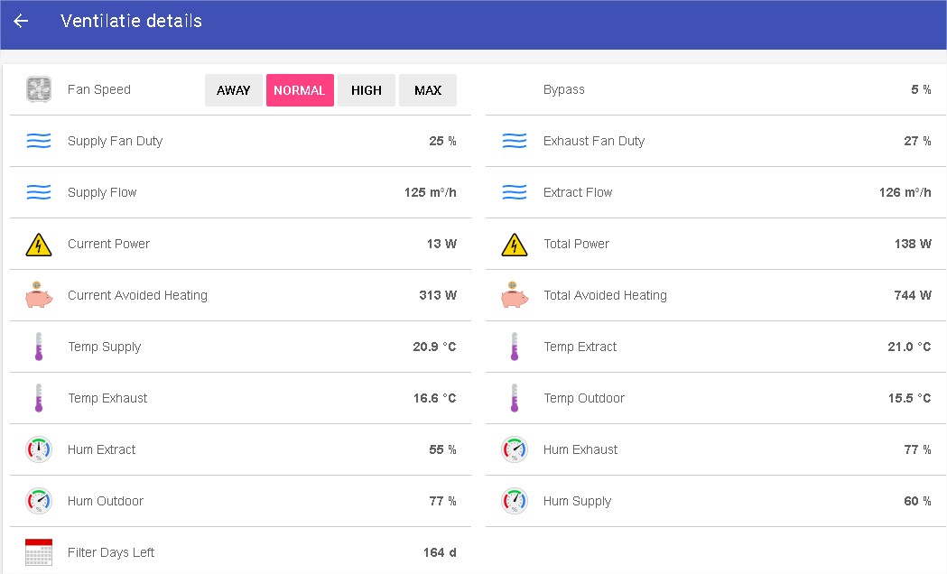

Using the code from michaelarnauts i’ve build a gateway (in python) that subscribes & publishes messages using MQTT.
So it’s possible to set the fan speed and read all the (interesting) paramters from OpenHAB2.

The gateway I posted above actually makes it platform independent because it’s using MQTT. All you need to do is configure the gateway, start it, and then using the openhab mqtt connector bind it to your items.
So I don’t see why this should be a binding, when it’s actually broader than that atm.
