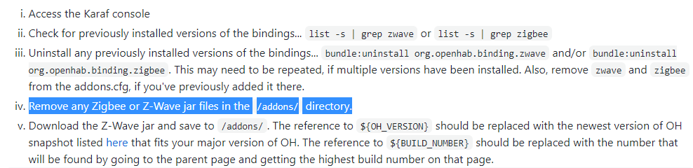

edit: nevermind. did the:
openhab> bundle:update org.openhab.binding.zwave *.jar

It looks like you have to uninstall the bindings manually. I am unable to get it to uninstall Z-Wave. This is what it’s running:
openhab> bundle:uninstall 'org.openhab.binding.zwave;' feature:install 'openhab-transport-serial;'
Error executing command: No matching bundles
I assume it’s trying to use OH2 names for OH3 components?
I don’t have a testing system running and I do not want to play with my active system. However the bundle path looks right to me.
I’d recommend that you uninstall the binding via the GUI and then install the development version using the script. This was how I did it.
