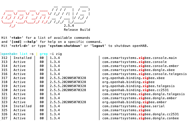

I updated my openhab instance to the latest stable version (Openhab 2.5.4) and updated also the Zigbee binding to the latest version using this script (Script 1.2.7).
When booting openhab, I get the following error in the log, but even the binding seems to be working.

2020-05-09 12:27:37.600 [WARN ] [org.apache.felix.fileinstall ] - Error while starting bundle: file:/usr/share/openhab2/addons/com.zsmartsystems.zigbee.console.main.jar
org.osgi.framework.BundleException: Could not resolve module: com.zsmartsystems.zigbee.console.main [312]
Unresolved requirement: Import-Package: com.zsmartsystems.zigbee.serial; version="[1.3.0,2.0.0)"
-> Export-Package: com.zsmartsystems.zigbee.serial; bundle-symbolic-name="com.zsmartsystems.zigbee.serial"; bundle-version="1.3.4"; version="1.3.4"; uses:="com.zsmartsystems.zigbee.transport,jssc"
com.zsmartsystems.zigbee.serial [324]
Unresolved requirement: Import-Package: jssc
at org.eclipse.osgi.container.Module.start(Module.java:444) ~[org.eclipse.osgi-3.12.100.jar:?]
at org.eclipse.osgi.internal.framework.EquinoxBundle.start(EquinoxBundle.java:383) ~[org.eclipse.osgi-3.12.100.jar:?]
at org.apache.felix.fileinstall.internal.DirectoryWatcher.startBundle(DirectoryWatcher.java:1260) [bundleFile:3.6.4]
at org.apache.felix.fileinstall.internal.DirectoryWatcher.startBundles(DirectoryWatcher.java:1233) [bundleFile:3.6.4]
at org.apache.felix.fileinstall.internal.DirectoryWatcher.startAllBundles(DirectoryWatcher.java:1221) [bundleFile:3.6.4]
at org.apache.felix.fileinstall.internal.DirectoryWatcher.doProcess(DirectoryWatcher.java:515) [bundleFile:3.6.4]
at org.apache.felix.fileinstall.internal.DirectoryWatcher.process(DirectoryWatcher.java:365) [bundleFile:3.6.4]
at org.apache.felix.fileinstall.internal.DirectoryWatcher.run(DirectoryWatcher.java:316) [bundleFile:3.6.4]
2020-05-09 12:27:37.614 [WARN ] [org.apache.felix.fileinstall ] - Error while starting bundle: file:/usr/share/openhab2/addons/com.zsmartsystems.zigbee.serial.jar
org.osgi.framework.BundleException: Could not resolve module: com.zsmartsystems.zigbee.serial [324]

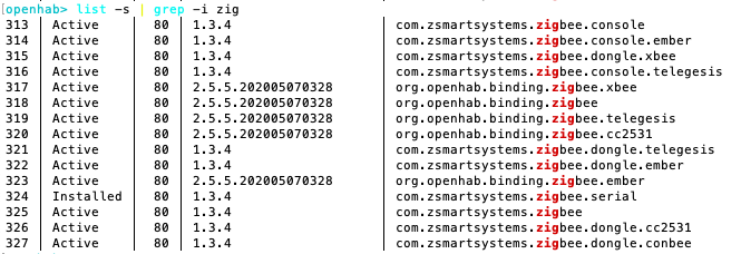

@5iver does the script pull in this JAR? If so, it shouldnāt - this seems to be causing a missing dependency on jssc library, but the console canāt run within Karaf.
@autossincool if you see the file com.zsmartsystems.zigbee.console.main.jar in your addons folder, please remove it and see if it starts.

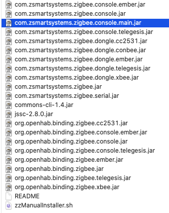

The following files are available in the addons directory. Are those correct?
Personally, I would recommend moving all those manually installed bindings aside, get openHAB 2.4.4 running and install the Zigbee binding. You should then be able to replace the install script and run it to update to the snapshot binding, if desired.
I suspect that if running 2.5.x the script expects you to have already installed the Zigbee binding which also installs the serial binding.
If the same error is coming up, then the file is presumably still in the system. It could be cached in which case you would need to uninstall it using Karaf.
I can still see the file I said needs removing in this image which may explain why the problem is still thereā¦
It doesā¦
If this should not have been included, then I am confused about this deliverableā¦

Sorry I was not clear with my last post. Iāve made the screenshot before Iāve deleted the file ācom.zsmartsystems.zigbee.console.main.jarā
After another reboot the console.main is not available anymore, but the following error is still there.
2020-05-09 16:34:18.933 [WARN ] [org.apache.felix.fileinstall ] - Error while starting bundle: file:/usr/share/openhab2/addons/com.zsmartsystems.zigbee.serial.jar
Iāve seen the script gives also the option ā4) Install serial transportā - which Iāve executed.
@5iver: I guess itās not required to install the zigbee binding through PaperUI in advance, right?
Delete the bundle com.zsmartsystems.zigbee.serial.jar as well. I donāt think this will make any difference though as the binding is running.
Iāve done so. Issue is gone and the binding is still working.
