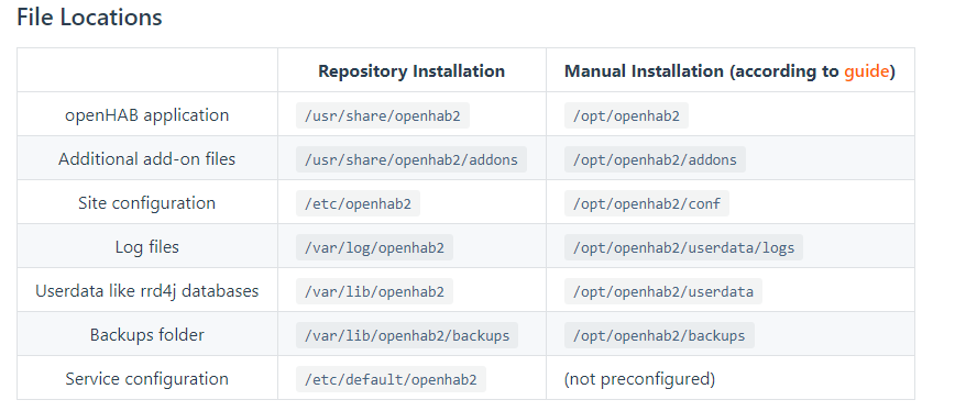

I’m aiming for a script install of the Zwave SNAPSHOT on a fresh OH2.5.1-2 RPi4B installation, but which directory do I copy the Script to? The README.md says to the addons directory, but which directory is that on an openHABian package installation?
The reason instructions are vague is because the location varies depending on the installation method. For you, it is likely /usr/share/openhab2/addons.
from openHAB on Linux | openHAB
I added a link to the file locations documentation.

I opened that particular directory on my running system with Zwave and Astro binding, but the directory is empty, just the README. That surprised me, and you?

This is expected. The /addons/ directory only contains your manually installed addons. Most people will not have anything in there.
