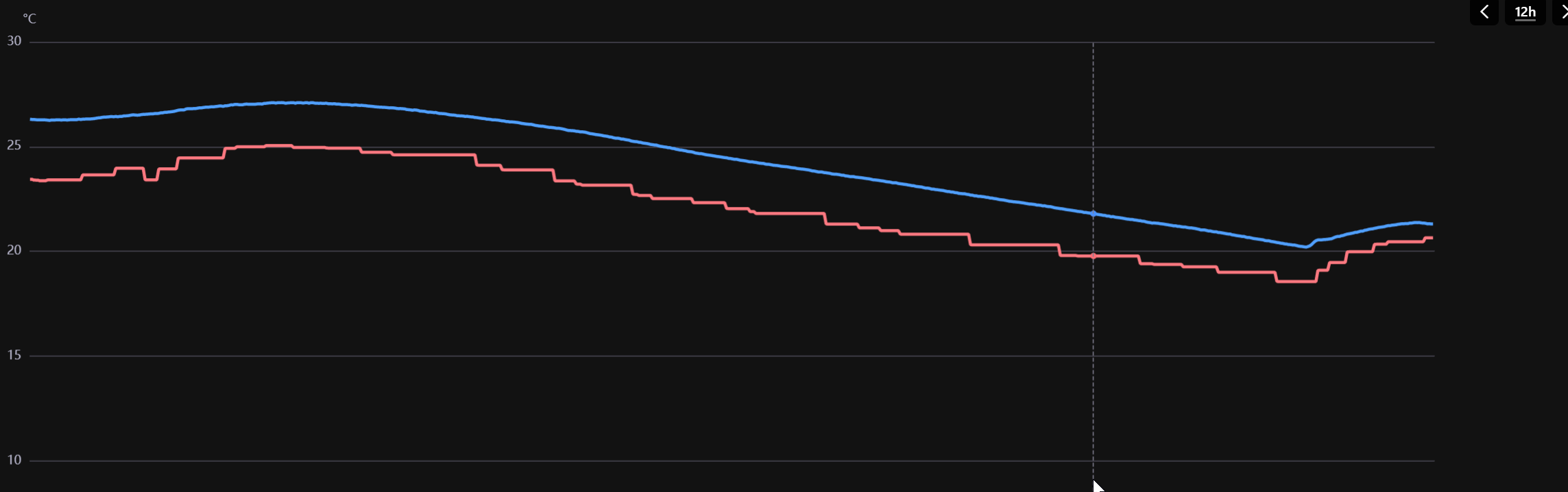

They do not send updates anywhere near as often as the Sonoff brand version. See this on the difference in their resolution. So they probably trade some resolution to increase battery life, to be fair the steps you see are only 0.5 degrees different so it is accurate enough. The sonoff uses a battery that holds around 2-3 times the power.
Blue = SONOFF SNZB-02
Red = Aqara
