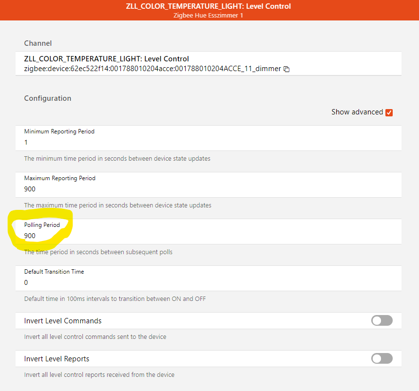

For this issue I’ve tried already to send the desired values in a cycle (like every 30 seconds) but it seems to slow down the other bulbs in case i would turn them on by a zigbee switch.
Is there any strategy how to deal with those bulbs?

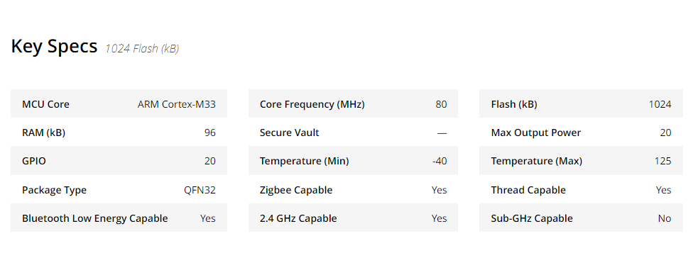

Hi Chris,
So my Zigbee stick as a “EFR32MG21A020F1024IM32” on board. Specs see below.
In general it behaves a bit like if the bulb did not received a command for a certain time then it’s offline in Openhab but online the level below.

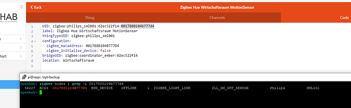

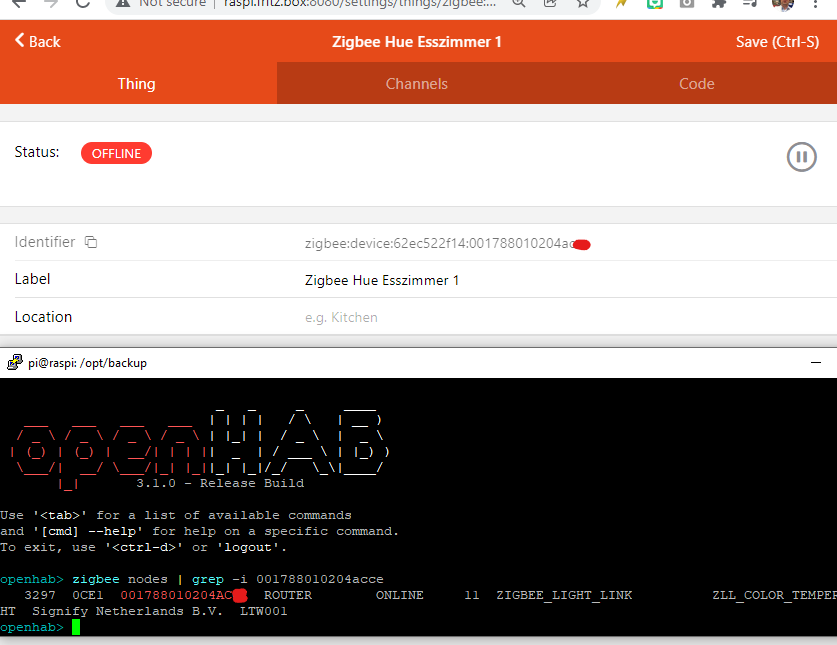

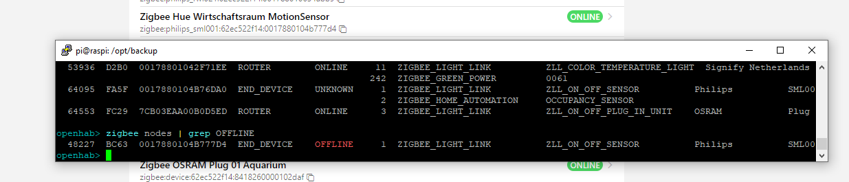

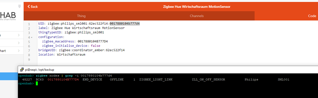

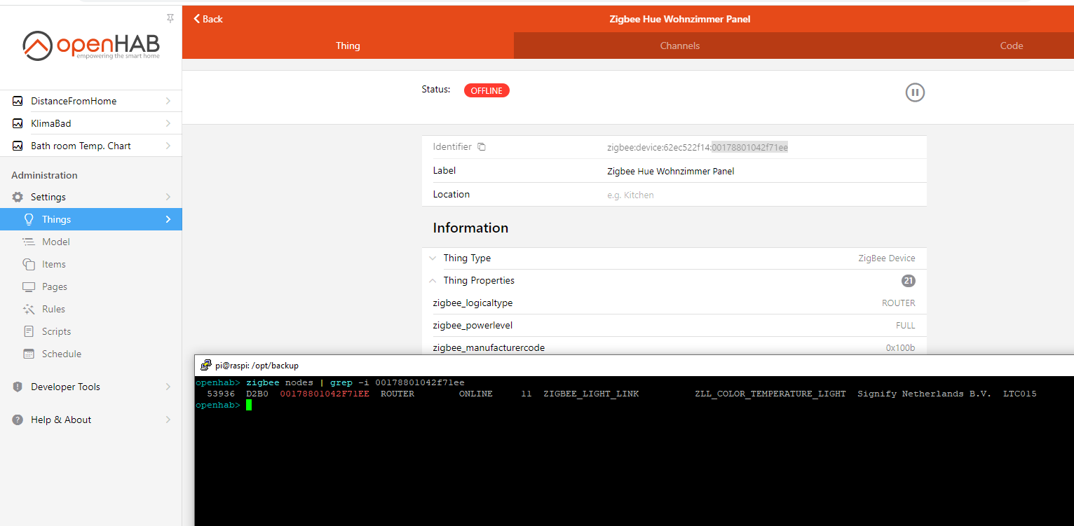

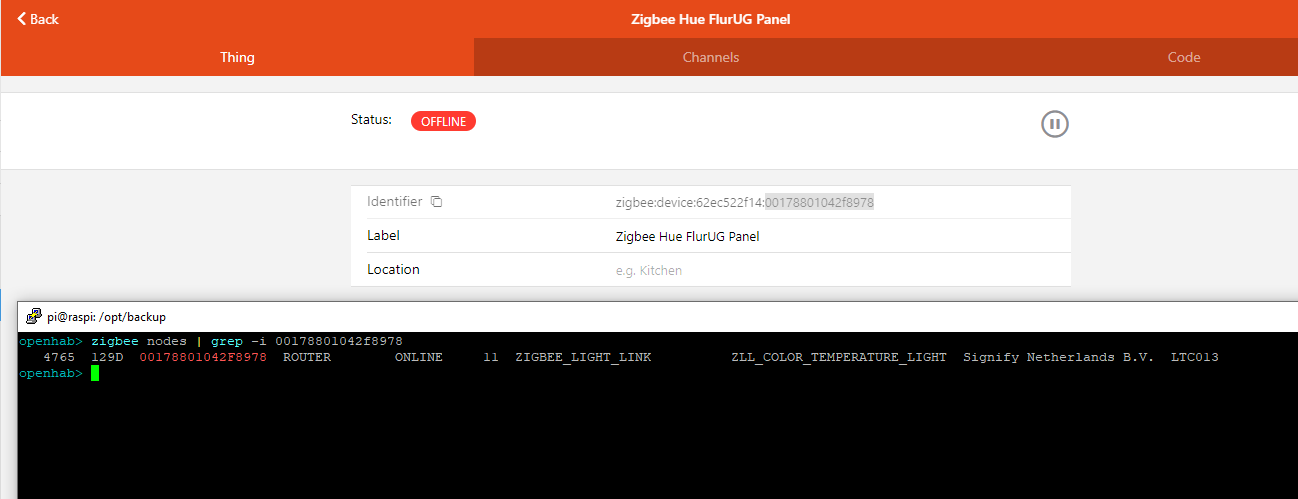

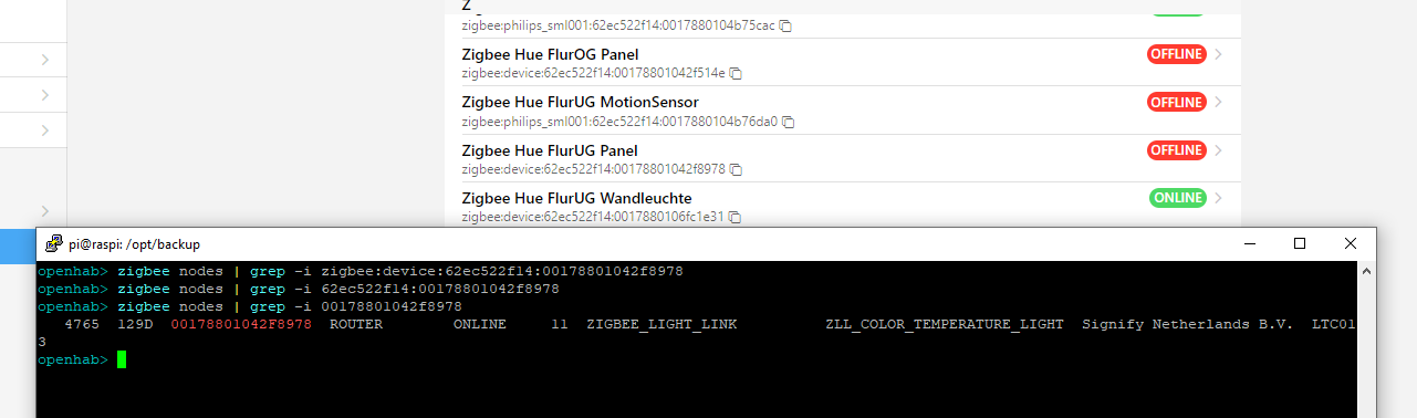

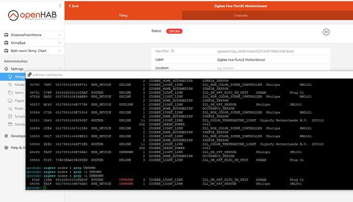

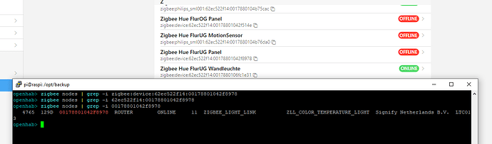

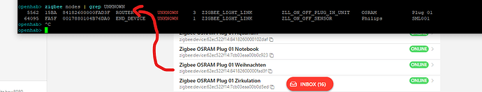

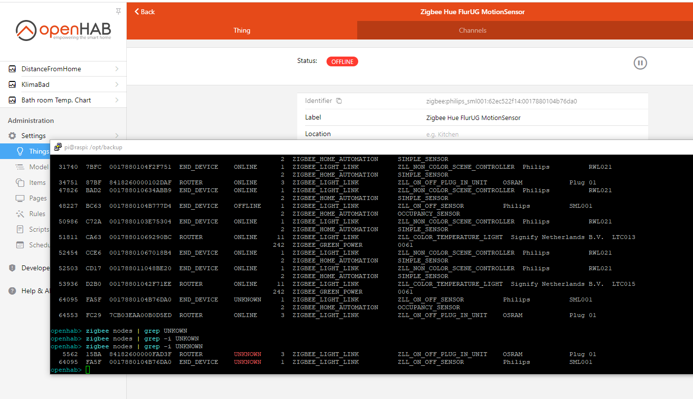

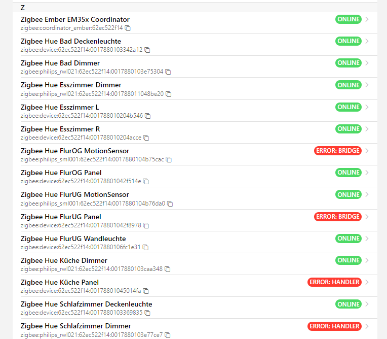

~ 12:24 (shortly before start I see that Error Handlers and Error Bridge appear
~ 12:43 First deviation between console and OH GUI. (OH Online but Console Offline)
Later on I reset this device - zigbee:philips_sml001:62ec522f14:0017880104b777d4 - and learn it again because it remains offline
~ 12:47 The device (zigbee:device:62ec522f14:84182600000fad3f) shown in that image is not plugged into the MAINS.
It’s offline in the Console but Online in OH. (The Switch is used for the Christmas Tree that is not yet installed therefore the SmartPlug is in the Box for Christmas things)

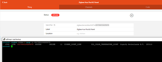

~12:57 Device “Zigbee Hue FlurUG Panel” (00178801042F8978) reports offline in OH, but is online in the console and reacts instantly on command on his LevelControl.
~13:07 Added Motion Sensor again (reset) → working( zigbee:philips_sml001:62ec522f14:0017880104b76da0)
~13:08 Seen that Wohnzimmer Panel (00178801042f71ee) is offline in OH but shows online in the Console)
~ 13:14 Learned Motion sensor again because it was offline too (0017880104B777D4)
~13:15 Finally the Dimmer Switch in the Sleeping room is working again (before it was just showing a red led) - 0017880103E77CE7

While these sorts of workarounds may be necessary - eg if as stated the Ikea devices have a bug - I would really try and focus on understanding why devices are OFFLINE. Unless the devices are physically powered off, they shouldn’t really go offline as they should report back to the binding, or the binding will also poll them to see if they are there before marking them offline.
I would generally discourage sending refresh commands regularly - this sort of thing can clog up the network as already stated above if devices are really offline, and if they are online, they should be reporting (so really should not go offline).

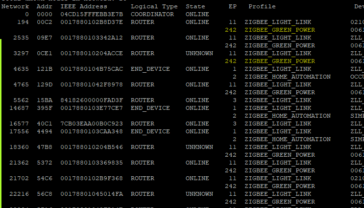

How can i check the binding table?
If I check it like below I always have just one direct connection from the router to the coordinator.
(But maybe I’m wrong)
openhab> zigbee nodes | grep ROUTER
    194  00C2  0017880102B8D37E  ROUTER        ONLINE     11  ZIGBEE_LIGHT_LINK          0210                       Signify Netherlands B.V.  LCT003
   2535  09E7  0017880103342A12  ROUTER        ONLINE     11  ZIGBEE_LIGHT_LINK          ZLL_COLOR_TEMPERATURE_LIGHT  Signify Netherlands B.V.  LTC012
   3297  0CE1  001788010204ACCE  ROUTER        UNKNOWN    11  ZIGBEE_LIGHT_LINK          ZLL_COLOR_TEMPERATURE_LIGHT  Signify Netherlands B.V.  LTW001
   4765  129D  00178801042F8978  ROUTER        ONLINE     11  ZIGBEE_LIGHT_LINK          ZLL_COLOR_TEMPERATURE_LIGHT  Signify Netherlands B.V.  LTC013
   5562  15BA  84182600000FAD3F  ROUTER        ONLINE      3  ZIGBEE_LIGHT_LINK          ZLL_ON_OFF_PLUG_IN_UNIT    OSRAM            Plug 01
  16577  40C1  7CB03EAA00B0C923  ROUTER        ONLINE      3  ZIGBEE_LIGHT_LINK          ZLL_ON_OFF_PLUG_IN_UNIT    OSRAM            Plug 01
  18360  47B8  001788010204B546  ROUTER        UNKNOWN    11  ZIGBEE_LIGHT_LINK          ZLL_COLOR_TEMPERATURE_LIGHT  Signify Netherlands B.V.  LTW001
  21362  5372  0017880103369835  ROUTER        ONLINE     11  ZIGBEE_LIGHT_LINK          ZLL_COLOR_TEMPERATURE_LIGHT  Signify Netherlands B.V.  LTC001
  21702  54C6  0017880102B9F368  ROUTER        ONLINE     11  ZIGBEE_LIGHT_LINK          0210                       Signify Netherlands B.V.  LCT003
  22216  56C8  00178801045014FA  ROUTER        UNKNOWN    11  ZIGBEE_LIGHT_LINK          ZLL_COLOR_TEMPERATURE_LIGHT  Signify Netherlands B.V.  LTC015
  22294  5716  00178801042F514E  ROUTER        ONLINE     11  ZIGBEE_LIGHT_LINK          ZLL_COLOR_TEMPERATURE_LIGHT  Signify Netherlands B.V.  LTC013
  23792  5CF0  0017880106FC1E31  ROUTER        ONLINE     11  ZIGBEE_LIGHT_LINK          0210                       Signify Netherlands B.V.  LCW002
  34751  87BF  8418260000102DAF  ROUTER        ONLINE      3  ZIGBEE_LIGHT_LINK          ZLL_ON_OFF_PLUG_IN_UNIT    OSRAM            Plug 01
  51811  CA63  00178801069290BC  ROUTER        ONLINE     11  ZIGBEE_LIGHT_LINK          ZLL_COLOR_TEMPERATURE_LIGHT  Signify Netherlands B.V.  LTC013
  53936  D2B0  00178801042F71EE  ROUTER        ONLINE     11  ZIGBEE_LIGHT_LINK          ZLL_COLOR_TEMPERATURE_LIGHT  Signify Netherlands B.V.  LTC015
  64553  FC29  7CB03EAA00B0D5ED  ROUTER        ONLINE      3  ZIGBEE_LIGHT_LINK          ZLL_ON_OFF_PLUG_IN_UNIT    OSRAM            Plug 01
openhab> zigbee bindtable 194
Binding table for node 194 [0017880102B8D37E]
Src Address          | Dest Address         | Group | Mode    | Cluster
0017880102B8D37E/11  | 04CD15FFFEBB3E7B/1   |       | Address | 0300:COLOR_CONTROL

84182600000FAD3F/3   | 04CD15FFFEBB3E7B/1   |       | Address | 0006:ON_OFF
openhab> zigbee bindtable 16577
Binding table for node 16577 [7CB03EAA00B0C923]
7CB03EAA00B0C923/3   | 04CD15FFFEBB3E7B/1   |       | Address | 0006:ON_OFF
7CB03EAA00B0C923/3   | 04CD15FFFEBB3E7B/1   |       | Address | 0B04:ELECTRICAL_MEASUREMENT
openhab> zigbee bindtable 18360
Binding table read error: FAILURE
openhab> zigbee bindtable 21362
Binding table for node 21362 [0017880103369835]
0017880103369835/11  | 04CD15FFFEBB3E7B/1   |       | Address | 0300:COLOR_CONTROL
openhab> zigbee bindtable 21702
Binding table for node 21702 [0017880102B9F368]
0017880102B9F368/11  | 04CD15FFFEBB3E7B/1   |       | Address | 0300:COLOR_CONTROL
openhab> zigbee bindtable 22216
openhab> zigbee bindtable 22294
Binding table for node 22294 [00178801042F514E]
00178801042F514E/11  | 04CD15FFFEBB3E7B/1   |       | Address | 0300:COLOR_CONTROL
openhab> zigbee bindtable 23792
Binding table for node 23792 [0017880106FC1E31]
0017880106FC1E31/11  | 04CD15FFFEBB3E7B/1   |       | Address | 0300:COLOR_CONTROL
openhab> zigbee bindtable 34751
Binding table for node 34751 [8418260000102DAF]
8418260000102DAF/3   | 04CD15FFFEBB3E7B/1   |       | Address | 0B04:ELECTRICAL_MEASUREMENT
8418260000102DAF/3   | 04CD15FFFEBB3E7B/1   |       | Address | 0006:ON_OFF
openhab> zigbee bindtable 51811
Binding table for node 51811 [00178801069290BC]
00178801069290BC/11  | 04CD15FFFEBB3E7B/1   |       | Address | 0300:COLOR_CONTROL
openhab> zigbee bindtable 53936
Binding table for node 53936 [00178801042F71EE]
00178801042F71EE/11  | 04CD15FFFEBB3E7B/1   |       | Address | 0300:COLOR_CONTROL
openhab> zigbee bindtable 64553
Binding table for node 64553 [7CB03EAA00B0D5ED]
7CB03EAA00B0D5ED/3   | 04CD15FFFEBB3E7B/1   |       | Address | 0B04:ELECTRICAL_MEASUREMENT
7CB03EAA00B0D5ED/3   | 04CD15FFFEBB3E7B/1   |       | Address | 0006:ON_OFF
What I also tried is to query the ncprouting, but ends up with an error message
openhab> zigbee ncprouting
An unexpected error occurred during execution.

Is there anything else that could help for better diagnostics?
