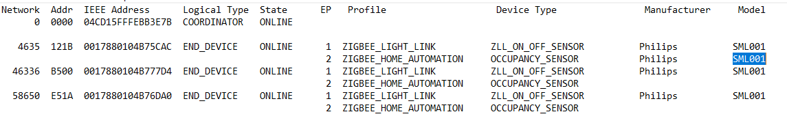

Should the bind table return more than one record for these devices?

Hmmm… Probably, yes. I think I would expect 3 entries (or more) for the 3 clusters a color command uses. Or two for a dimmer, or one for a normal on./off bulb - plus more if there is electrical power monitoring (as I see here).
I know we had an issue in the past with some older Hue bulbs as they only had a single binding table entry.
Note that this probably won’t impact on the offline problem - it will just mean that some status changes aren’t reported, but some reports should still be sent, so the device shouldn’t go offline due to having a limited number of binding table entries.
Note also that you can add entries to the binding table (with the bind command) so you could try and add an entry for cluster 6 in device 4765 for example which only shows the colour cluster - it should also support on/off (ie cluster 6) and dimming (cluster 8). It might be interesting to set this to see if you get an error returned.

as I leared today some motion sensors again I found also a smal deviation in the display of the model in the nodes list.
For the Endpoint 2 there is an entry of the model, but only for one of the 3 Motion sensors.
Does this have a meaning?

I guess it just means that the lower level doesn’t currently have this information. It’s not really critical as the binding will cache this itself, but it possibly means that the XML files were deleted at some point (which is where this is stored).

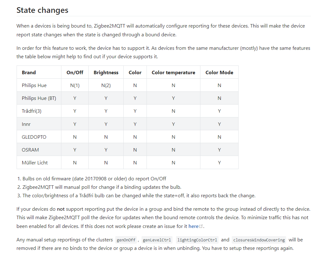

To detect if the device is online or offline before sending I tried to use the function shown below.
I also used this for the devices that where connected to the MAINS and could be disconnected.
Result: The devices remain offline (for hours).
Assumption: if i do not send a command the device remains offline even if its connected back to the mains.
Second: I’ve tried to bind several hue bubls to cluster 6, even the newest model in my house Hue Liane
returns “TABLE_FULL” (having the latest Hue FW installed)
openhab> zigbee bind 0006 23792/11
Error executing command: CommandResult [ERROR (UNKNOWN,0xFF), BindResponse [5CF0/0 -> 0000/0, cluster=8021, TID=DB, status=TABLE_FULL]]

The “zigbee bindtable xxxx” command will only show one line for those problematic ones.
In addition they are all “ZIGBEE_LIGHT_LINK”
I have only one Hue bulb that is “ZIGBEE_HOME_AUTOMATION” (6386 Philips LTA001) and only one non-Hue that is “ZIGBEE_LIGHT_LINK” (23145 Osram).
The Philips LTA001 seemingly do not show as offline but still working.

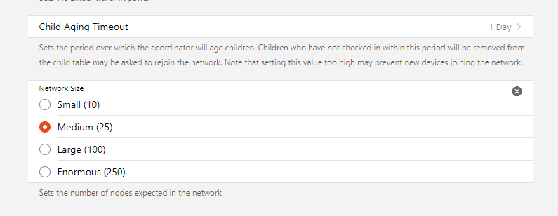

About the TABLE_FULL” does this mean Table full in the Coordinator or in the Device (Bulb)?
Could it help to increase the Zigbee Network Size?

and one more thing, could it be simply that Hue Bulbs do not send reports?
Source: Binding | Zigbee2MQTT
Are devices set back to online if they answer on a poll?
Looking at the table, it make sense :slight_smile:

Edit1: All my bulbs get a color temperature change every few minutes.
That is not enough to keep the older Hue bulbs (without BT) registered as online.
They answer back only to a Brightness command.
Also my ZLL_DIMMABLE_LIGHT Philips 1743630P7 do register as online again when changing the dimmer value.
I just watched it go from offline to online when refreshing its brightness value (zero, it is a outdoor lamp).
