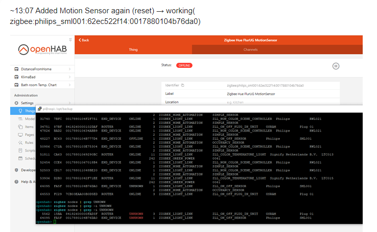

Hi Chris,
thanks for doing the logfile analysis! Thats really great so far.
Yes with that Device (its a SML001 Motion Sensor von Philipps) I often phase issues.
UID: zigbee:philips_sml001:62ec522f14:0017880104b777d4
label: Zigbee Hue Wirtschaftsraum MotionSensor
thingTypeUID: zigbee:philips_sml001
configuration:
  zigbee_macaddress: 0017880104B777D4
bridgeUID: zigbee:coordinator_ember:62ec522f14
But on the other hand the Motion sensor is not too far (2 walls on the same level) away from the coordinator and really close to a Zigbee panel that is always connected to the MAINS.
I often need to relearn this Sensor back to the network because it “stucks” (seems to be online but not reporting data).
BR
/Franz

If i recapitulate the only thing that makes the device work again (It did not worked during the Parent change was to reset it.
Hi @chris,
I did some more research and found some interesting things in this thread:
It seems to be related to “source_routing”
Some Commits are described here:
This thread is not really relevant - as far as I understand you are using the Ember chipset (or am I wrong)? This thread is about the CC2531 and it’s not really possible to use source routing as the NCP does all the routing.
Hello @chris,
Thanks for the update here.
Yes I’m using an Ember chipset EFR32MG21.
Okay I’m still in the learning phase and not yet aware about what does what when.
But the Symptoms are exactly what the same here. The device disconnects and creates trouble in the Network.
The most weired thing here is that i have 3 SML001 Hue Sensors.
One of them required to be learned multiple times (0017880104B75CAC), that is showing the name also twice below but is working now fine since round about 14 days.
openhab> zigbee nodes | grep SML001
   4635  121B  0017880104B75CAC  END_DEVICE    ONLINE      1  ZIGBEE_LIGHT_LINK          ZLL_ON_OFF_SENSOR          Philips          SML001
                                                           2  ZIGBEE_HOME_AUTOMATION     OCCUPANCY_SENSOR           Philips          SML001
  10095  276F  0017880104B76DA0  END_DEVICE    ONLINE      1  ZIGBEE_LIGHT_LINK          ZLL_ON_OFF_SENSOR          Philips          SML001
  26647  6817  0017880104B777D4  END_DEVICE    ONLINE      1  ZIGBEE_LIGHT_LINK          ZLL_ON_OFF_SENSOR          Philips          SML001
The Second one is the one where you’ve seen the log already. (Disconnects daily)
And the 3rd one is also disconnecting nearly daily.
For this one I’ve took a closer look in the file file below.
The whole thing worked till 20:18 and then the sensor did no longer report data and stopped at “ON”.
The next transaction was then 10 minutes later at 20:28.
I guess one defect device could maybe be an hardware issue but two is very unlikely.
But for sure I would be also willing to exchange the Sensors.

Hello Friends,
I want to give you a short update on this topic (Maybe also for other guys that read this article)
I’ve replaced all of my Osram Smart Plug+ with a TS011F Plug (Neo NAS-WR01B).
Since then I never needed to repair the Hue Motion Sensors anymore!
@chris: Thanks again for the great analytics that figured out there is an issue with the ZigBee motion sensor
@NilsOF Thanks a lot sharing your experience with the Smart+ Plug.
BR
/Franz
