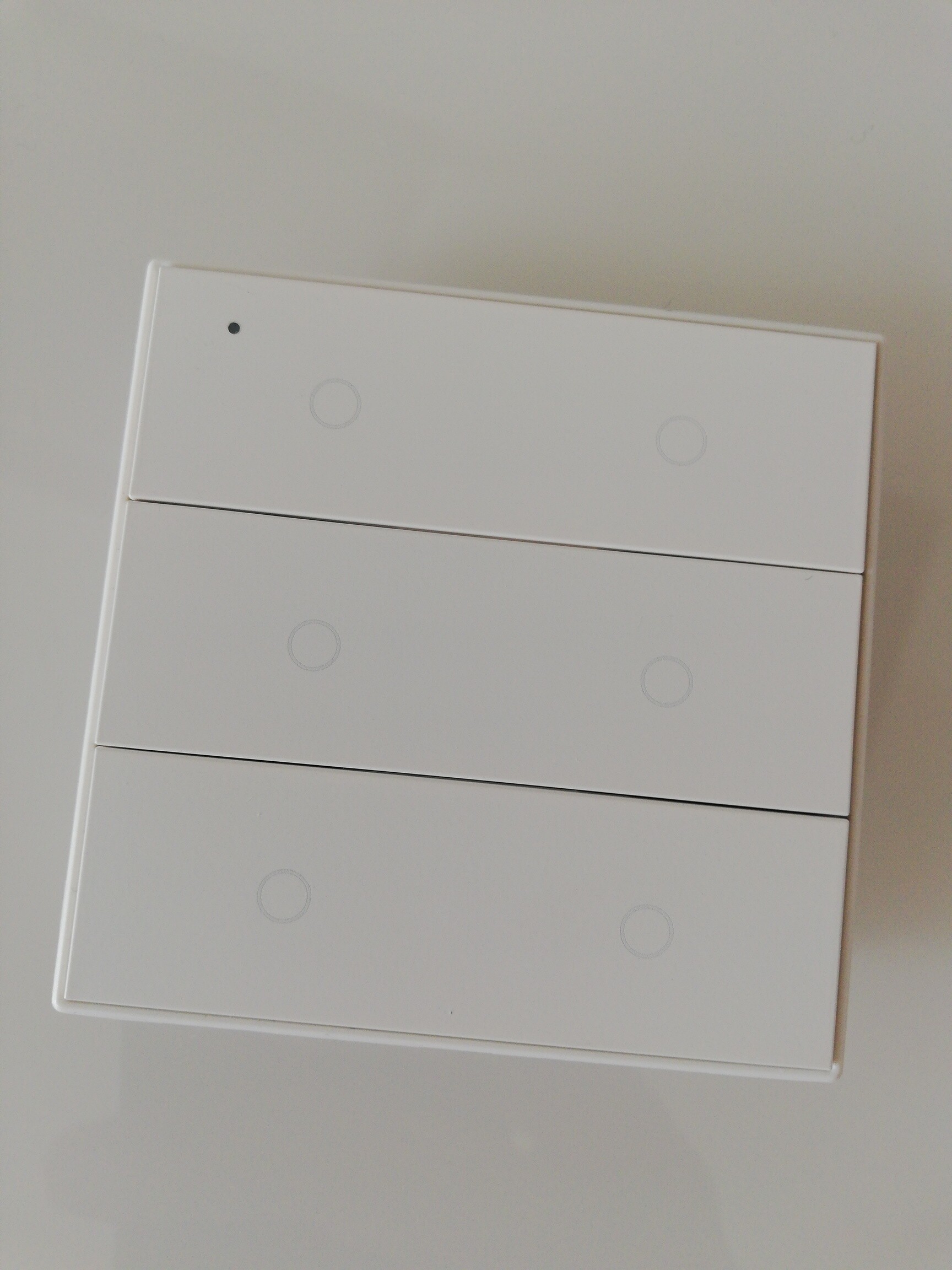

I got a 6 button version. I will try if it maybe already works. But want to change from xbee stick to another one first.

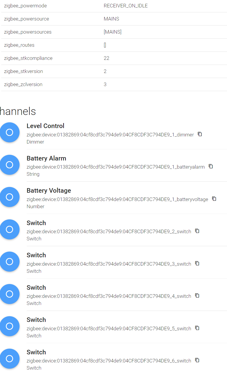

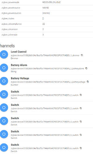

So I now added it to the network and in general it does join.
Seems not fully working though.
It is disocvered with 5buttons instead of 6 and also the powersource in the properties reads “Mains”.
Just to share this. I will see what works in more detail and update here.
