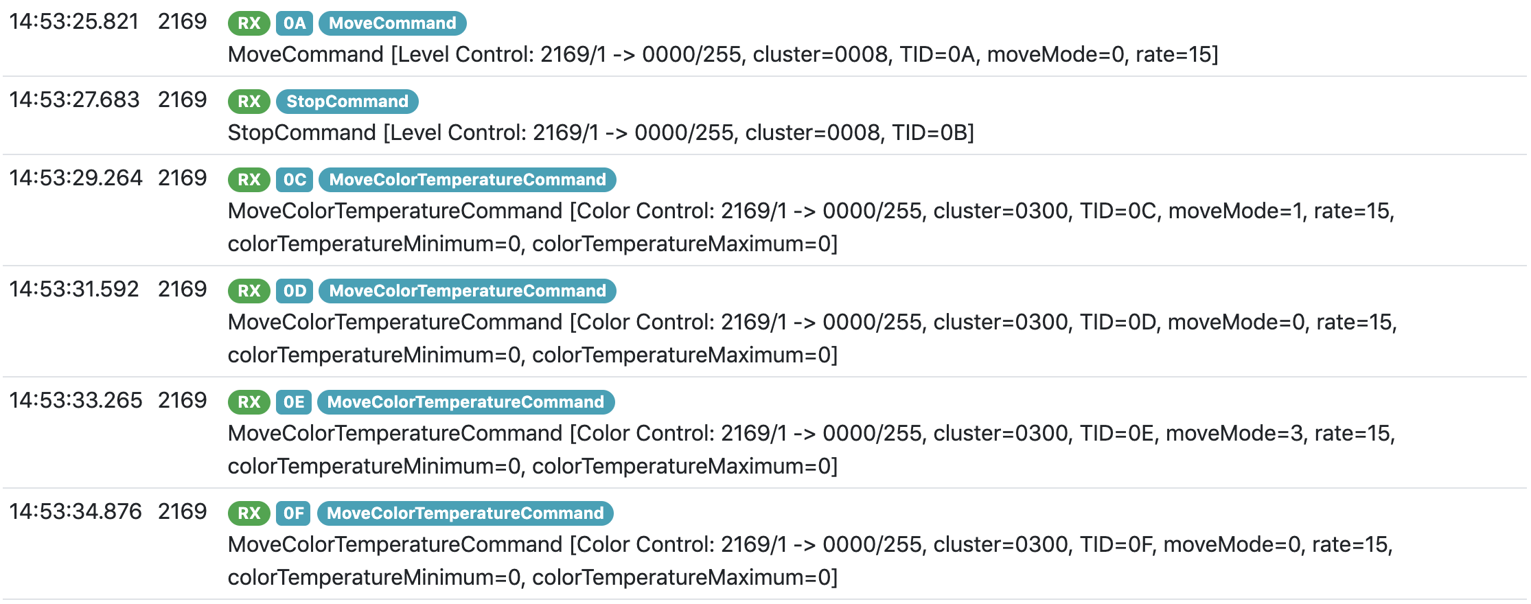

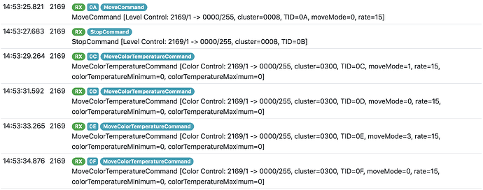

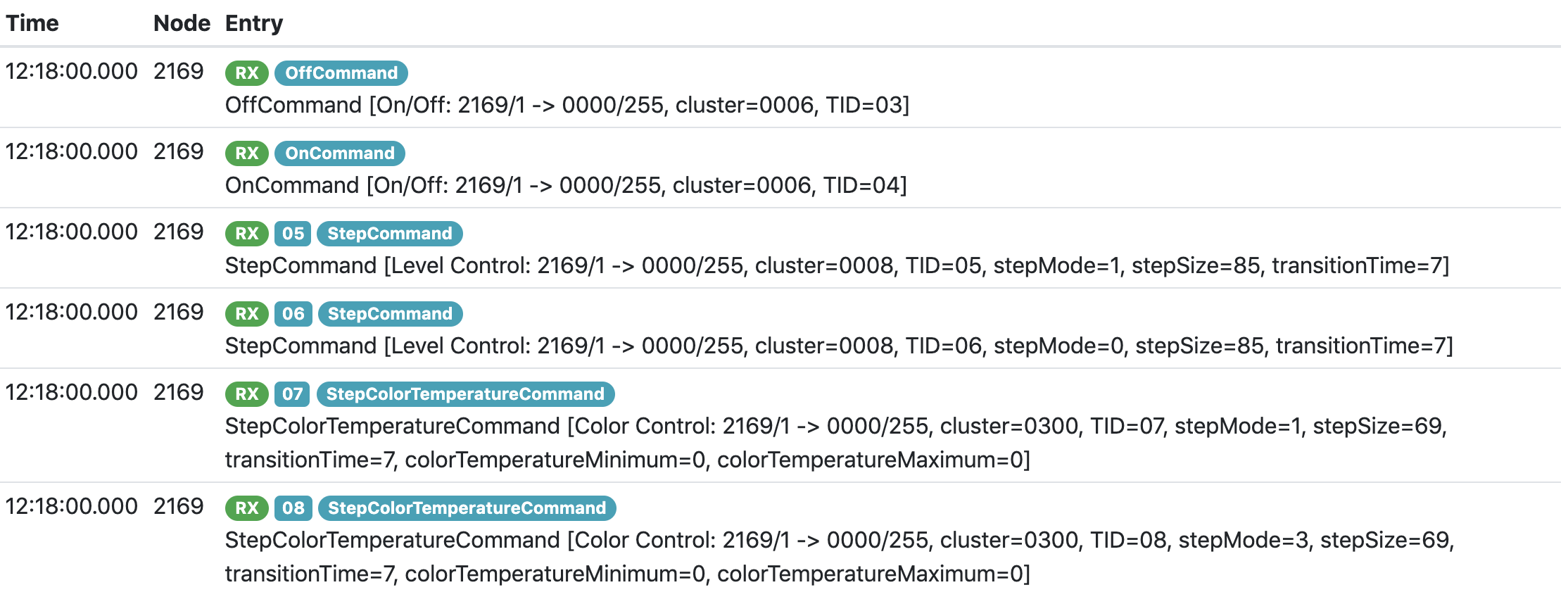

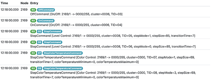

Sorry - I’m juggling a lot of balls here at the moment. I’ll see if I can include the device into one of my networks and see what it does today. Then at least I’ll have an idea for what doesn’t work.
Just dumping stuff here for longevity…
Only one endpoint supported -:
Node Descriptor  : NodeDescriptor [apsFlags=0, bufferSize=127, complexDescriptorAvailable=false, manufacturerCode=115F, logicalType=END_DEVICE, serverCapabilities=[], incomingTransferSize=100, outgoingTransferSize=100, userDescriptorAvailable=false, frequencyBands=[FREQ_2400_MHZ], macCapabilities=[REDUCED_FUNCTION_DEVICE, MAINS_POWER], extendedEndpointListAvailable=false, extendedSimpleDescriptorListAvailable=false, stackCompliance=22]
Power Descriptor : PowerDescriptor [currentPowerMode=RECEIVER_ON_IDLE, availablePowerSources=[MAINS], currentPowerSource=MAINS, powerLevel=FULL]
Associations     : []
Endpoints        :
            1    : Profile     0104 ZIGBEE_HOME_AUTOMATION
                 : Device Type 0105 COLOR_DIMMER_SWITCH
                   -> BASIC
                   -> POWER_CONFIGURATION
                   -> IDENTIFY
                   <- IDENTIFY
                   <- ON_OFF
                   <- LEVEL_CONTROL
                   <- COLOR_CONTROL
Neighbors:
Routes:
Node Info             Value
DEBUG  16:17:46.941  transactionListenerRemoved: 0 outstanding
DEBUG  16:17:46.941  04CF8CDF3C77C009: transactionComplete COMPLETE 0
Application Version   17
Date Code             20190730
Generic Device Class  255
HW Version            1
Manufacturer Name     LUMI
Power Source          3
Product URL           www.aqara.com
SW Build ID           2019
Stack Version         2
ZCL Version           3
Short press…
Long press…
Double press seems the same as short press.
