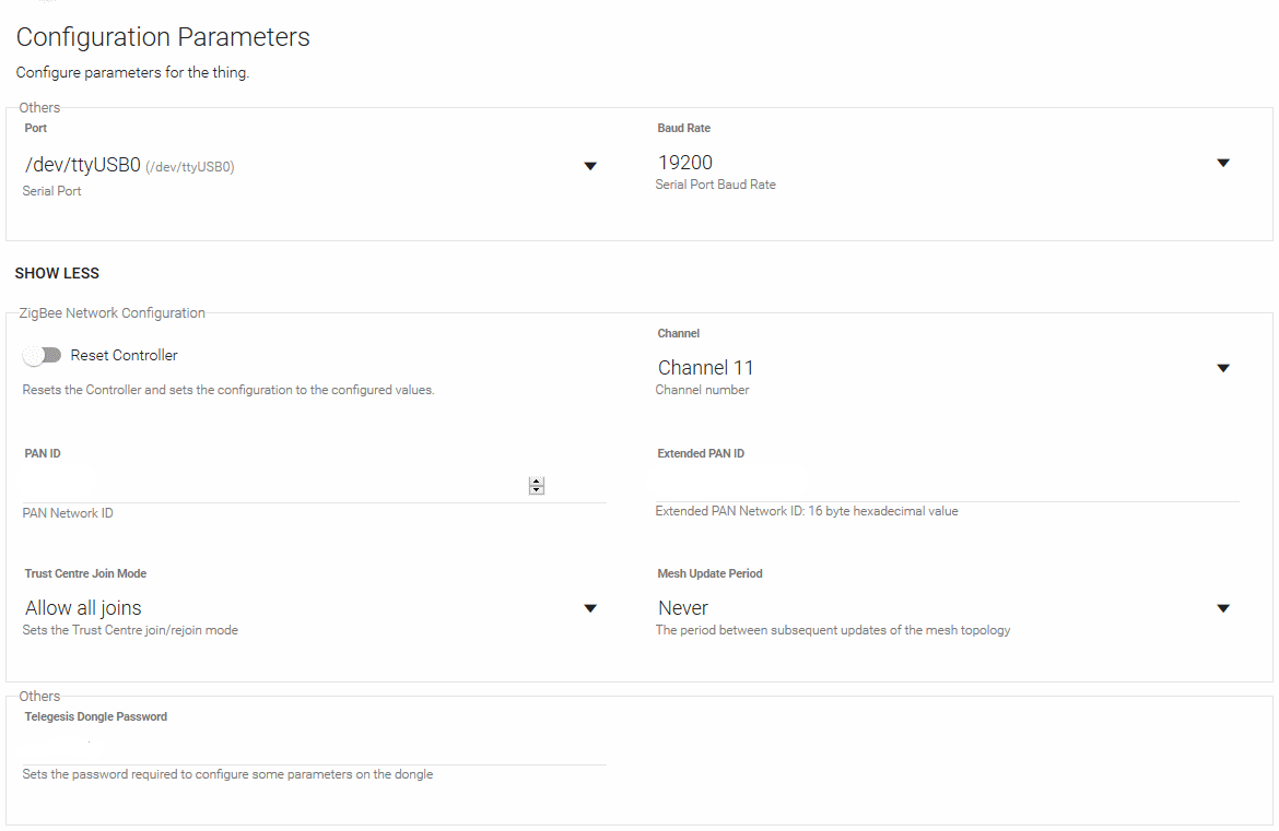

Hm, maybe it’s something Telegesis Stick-related?
Just to compare versions: I am openhab 2.5.0 with a snapshot from 2019-03-30. The Zigbee binding is labeled ‘2.5.0-SNAPSHOT’. So it should be the state as it was end if march.
18-16-20-07
EDIT: needed to edit the picture…
