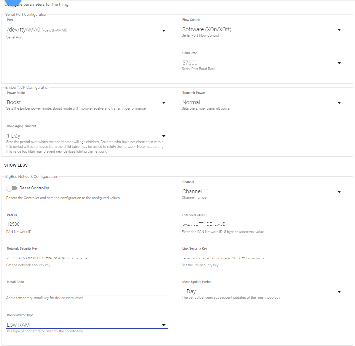

And then you´ll probably need my network securtiy key as well. Here is the coordinator settings..
