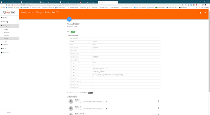

Hmm.. Not sure what you mean then.. This is the proberties of the Hue Dimmer Switch:

Btw.. did you see my screenshots of the properties?
It updates the mesh information in the properties - it doesn’t actually update routing as that is done on the fly.
Yes, but as I said, in your case I don’t think it’s going to be very useful as you are moving things around.
It looks the same for the Orsram plug socket, even when I dont move it.
