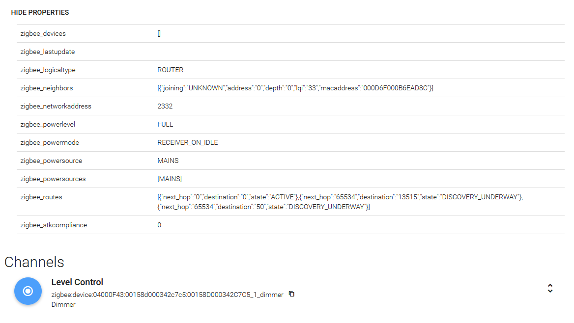

Hi @chris,
I tried adding an Innr FL 130 C lightstrip. The strip was found by the binding, though the name remains the mac address. Unfortunately the binding can only find a dimmer channel called “level control”. But this one changes nothing when played with.
I’m currently running the 2.5M1 milestone build. Other zigbee devices like Osram plugs & bulbs and Ikea Tradfri bulbs work flawlessly. I just can’t find any color channels on the Innr light strip. Can I add them somehow?
You can’t add channels yourself - these need to be added by the binding.
This probably means that there is an issue detecting the device information. I would strongly suggest to use the snapshot version as the M1 binding is quite old and there have been a lot of changes. I would also need to see a debug log during the initialisation to know what is happening.
