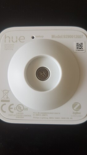

just for reference:
Hue motion sensor model:9290012607
and again, just to be clear, I can make my sensor report several times a minute, like Kim’s is in the log by putting my hand over the sensor then removing my hand from the sensor. It takes a couple seconds (maybe 2) for the lights to react but my can be made to report 4-5 times a minute like in Kim’s log snippet in first post. Basically… the sensor is capable of reporting that often
Wow - super old :wink:
