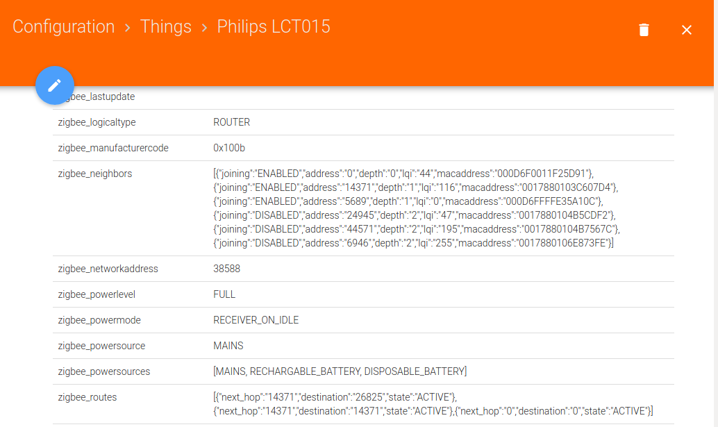

The problem is at sometime usually after 2 days the Mesh does not update the network moreover it creates a lot of dead links.
For example a device A may shows that it has a link to another device B but the device B does not show a link to device A as a result there are a lot of delays in the network and the mesh does not update to fix the problem ( I even set the mesh update period to 5 minutes)
Picture 1 Shows a device with all the neighbors

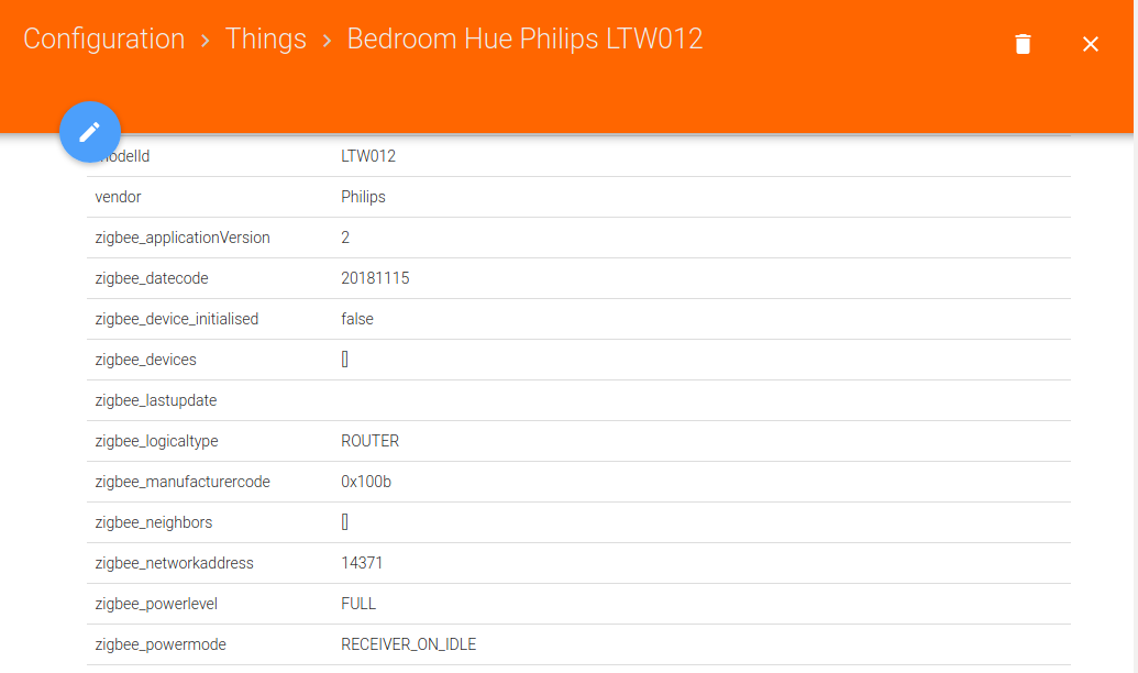

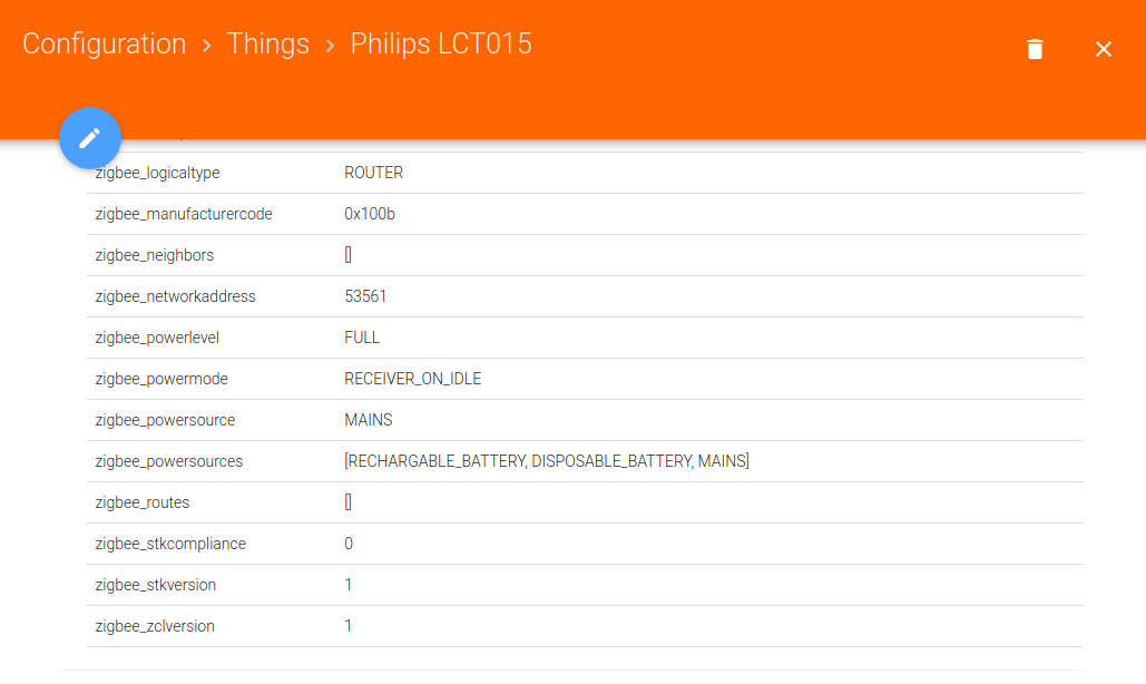

after a day or 2
When the problem happens if switch off a router device and then back on then the router device Will not find the near by devices but all the other devices that already have this device in their list will continue to list it in their neighboring device and in their routes
I have tested the above with hue bulbs and ikea wall plugs
To restore everything back to normal you have to clean the cache and restart, Restarting alone does not fix the problem

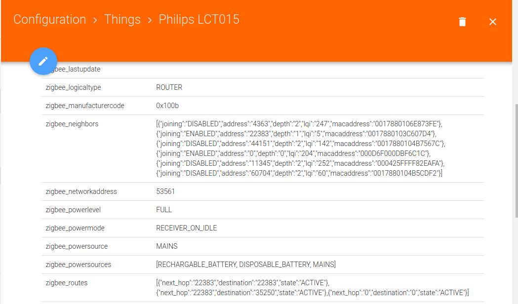

Another instance on the second pi with the same devices

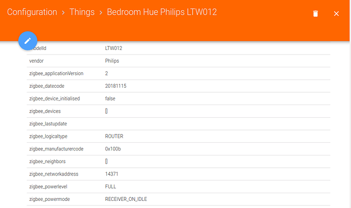

DEVICE 14371 HAS NO ROUTES NO NEIGHBOURS
BUT
A DEVICE 1 M AWAY LIST THIS ON ITS NEIGHBORS AND ROUTES
The mesh information that you show in these images does not necessarily mean that the network is not working. The coordinator manages the mesh - the binding does not have anything to do with this - it only provides this information periodically for information, but it does not update anything.
What is a “dead link”?
Wow many thanks for the fast reply
So the interface will not show the routes and neighboring devices in the Paper UI ? In the 2.4 you see messages in the log like ‘zigbee:device:01381645:001788010486f1f5’ has been updated. Now I do not see these messages moreover if a device goes offline and comes back online it will never show any neighboring devices is that normal?
if the paper UI will not show the actual links and neighbors then I do not have dead links. I was creating a graph using the information from the paper UI to see where I had the problem and I was assuming that some devices do not communicate with any other devices
The problem I have is that after 1-4 days the messages from the zigbee devices become very slow sometimes they take up to 2-5 seconds to reach openhab and sometimes they will not reach at all. I know that its a communication problem because the hue sensor has an led that lights up on movement where there is difficulty to sent a command. In order to resolve the problem I have to restart openhab and also clean the cache
Again thanks very much
