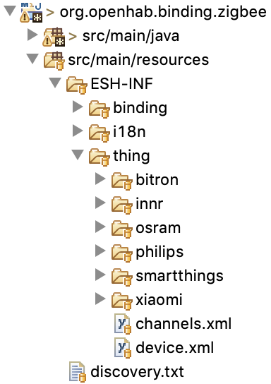

It’s part of the binding - it requires a thing definition to be added using the standard ESH XML format, and defining the channels and discovery data.
If you have a development environment, then the files are in the following section in the ZigBee binding -:
You can probably use one of the other files as a template - the channels that need to be added are mostly as the binding already discovered them (ie the temperature, batter alarm, voltage etc) but the button channel needs defining differently to work around the manufacturer specific definition. We could possibly add a new channel type, or we could use one of the existing IAS channels and just give it a different name. I’m open to discuss this and I’d need to take a look to see what looks like the best fit.
