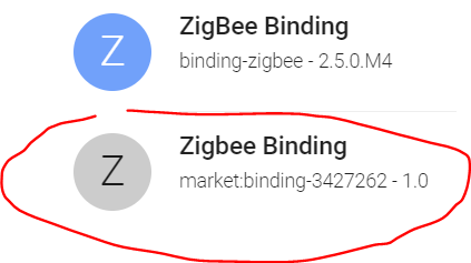

Btw.: What is the Zigbee binding in the marketplace?
Did I miss something?:wink:
I’m not sure - maybe it’s a really (really!) old version. It’s been a long time since I looked at the marketplace, but it was in there a few years ago so it’s probably that version.

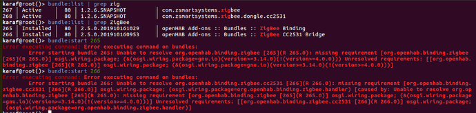

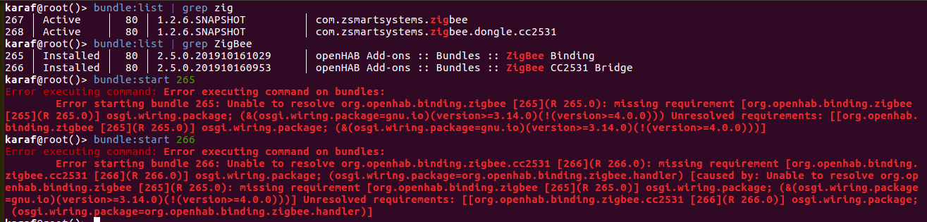

Hi
I am trying to get org.openhab.binding.zigbee.cc2531 to active state. Along with this binding I have included the following dependency bindings as mentioned in the previous comments
1. org.openhab.binding.zigbee
2. com.zsmartsystems.zigbee
3. com.zsmartsystems.zigbee.dongle.cc2531
The openhab packaging sample version that i am using is 2.5.0-SNAPSHOT
 After adding all these bindings when I am trying to start the installed zigbee bindings getting the following error :
So, what is the dependency I am missing out or there is any version miss match with the openhab packaging sample and the zigbee bindings.
Please help me out in doing this.
Thank you
