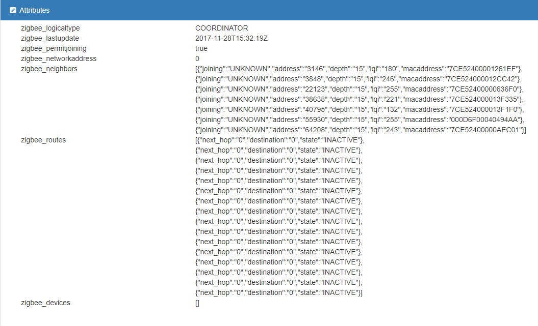

@chris, I saw a new unknown device show up, with nearly the same Attributes as the controller. I’m not sure what to do with this device. You’d stated that Things would not need to be deleted with the latest binding updates, but maybe the old controller needs to be removed?
Unknown Device
Controller
I’ll take a look at the discovery to see how it’s differentiating this. The address is 0, so this is the controller and it therefore shouldn’t be detected as a thing…
