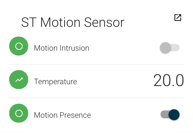

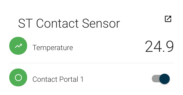

Tonight I hope to merge support for sensors - specifically, motion, occupancy and contact sensors, along with temperature and illuminance. Specifically, this supports the Hue motion sensor, and the SmartThings occupancy sensor and contact sensor.
Please let me know how this looks - there’s quite a bit of behind the scenes functionality required to get IAS sensors (so the ST sensors) to work. Currently, it will likely only work with the Telegesis dongle, but I’ll try and get the other dongles working tonight or tomorrow as well.
I will call this 2.2 feature complete and just look to iron out any issues that may come up.

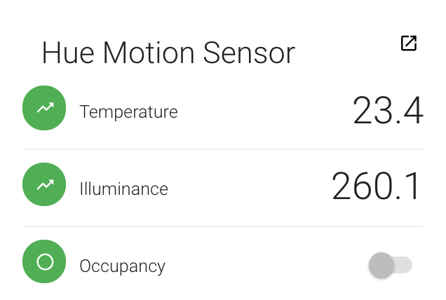

I have just switched to build 1129. Color channel works, Hue motion sensor works. Thanks!
Hue motion sensor only updates luminance when motion is detected. So it is not suited to trigger actions. Temperature seems lower than actual. I guess those are hardware limitations.

The Hue motion sensor sometimes doesn’t switch to “occupancy”, however, you can see that it has detected motion because the luminance starts updating while I move around. Maybe the updated status of “occupancy” got lost in communication? Could you poll for occupancy whenever luminance changes?
I’ll have a look at how the reporting is configured - maybe it’s not configured well at the moment.
This seems to be a startup error so presumably this doesn’t show the problem you had?
No - probably not very easily. Doing this starts to place dependancies between channels and it gets messy really quickly.

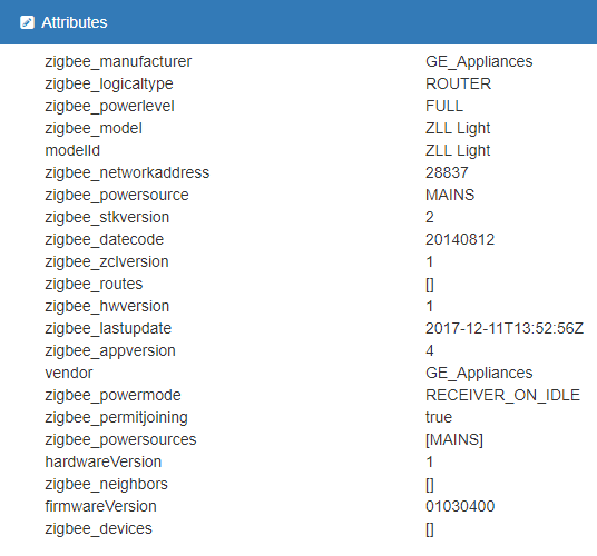

I have three GE Link bulbs that did not come online after startup. Two of them were offline before the restart though. A power cycle did not bring them back online. It’s only been about 30 minutes though. I see you’ve done something different for the device firmware versions. What format are you using? I also noted a slight delay in resposniveness. Normally, I expect this delay after a restart with zwave devices, but zigbee had been immediately responsive. There seems to be a delay now. I’m sure this will improve when my OH stabilizes, so just an observation.
I think this is the same we discussed last week, but I need to get a log that goes with this :frowning:
On it’s way :wink:
Cool - thanks :slight_smile:
Are you talking about the firmware version in PaperUI (ie not in the properties section)? If so, this is related to the Firmware cluster - so it’s the firmware version that the OTA Firmware upgrade system uses which (strangely!) is different than the information in the basic cluster.
Habmin> Configuration> Things> Device> Attributes> firmwareVersion (I think this is the same format I saw in ST)
Ok, so it’s the same as I mentioned above then. This is directly related to the OTA upgrade feature and this is a special property name specifically to support this.
