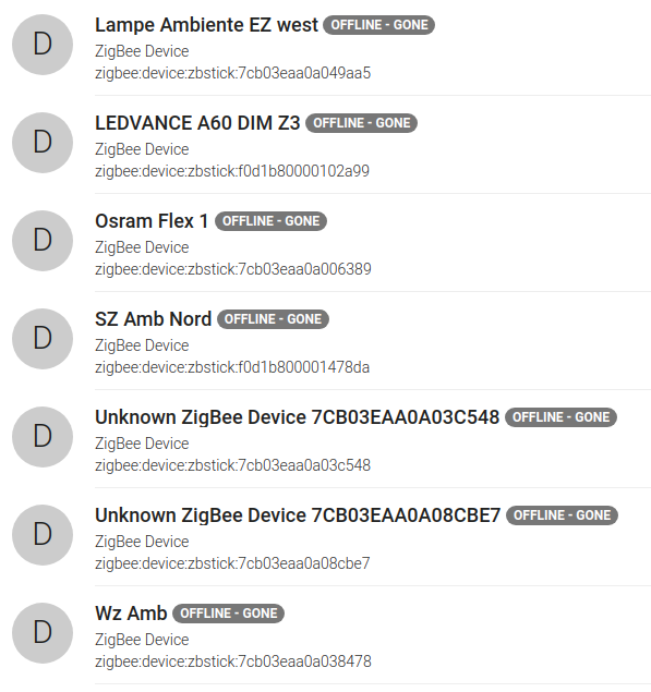

Then, after adding the first Ledvance E14 bulb via Zigbee, I suddenly noted that it was no longer possible to control any Zigbee thing any more.
I rebooted the RPi4, and the situation is now as follows:
  • In the PaperUI, all Zigbee things (incl. the coordinator) are in status “unknown” or “offline”, no control possible any more
  • the Z-Wave things are in status “online” and can be controlled
    The log entries (filtered by “zigbee”) after a reboot look like that:

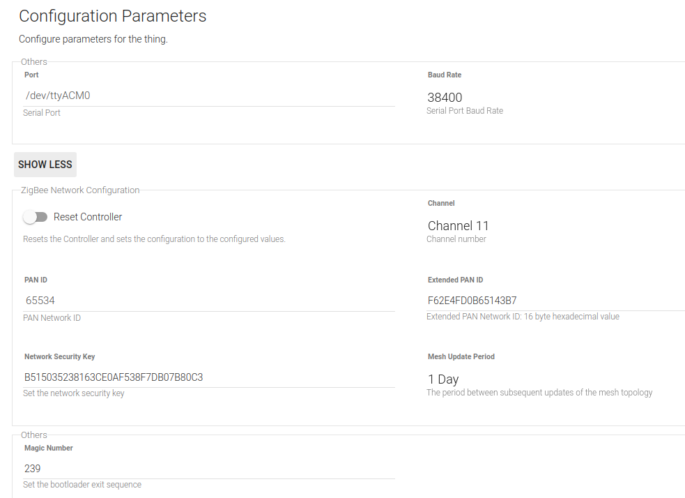

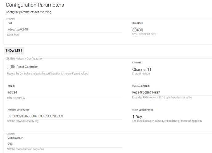

Hello @chris, as described in https://www.openhab.org/addons/bindings/zigbee/#when-things-don-t-appear-to-be-working , I have activated debug type logging via the karaf commands
log:set debug org.openhab.binding.zigbee
log:set debug com.zsmartsystems.zigbee
log:set info com.zsmartsystems.zigbee.dongle.ember.internal.ash
Then I rebooted the RPi 4 again and this is what I got in openhab.log:

2020-09-09 16:50:43.885 [DEBUG] [ng.zigbee.handler.ZigBeeThingHandler] - 7CB03EAA0A038478: Coordinator status changed to UNKNOWN.
2020-09-09 16:50:43.893 [DEBUG] [ng.zigbee.handler.ZigBeeThingHandler] - F0D1B80000102A99: Channel zigbee:device:zbstick:f0d1b80000102a99:F0D1B80000102A99_1_dimmer linked - no channel found.
2020-09-09 16:50:43.895 [DEBUG] [ng.zigbee.handler.ZigBeeThingHandler] - 7CB03EAA0A038478: Coordinator is unknown or not online.
2020-09-09 16:50:43.901 [DEBUG] [ng.zigbee.handler.ZigBeeThingHandler] - 7CB03EAA0A049AA5: Channel zigbee:device:zbstick:7cb03eaa0a049aa5:7CB03EAA0A049AA5_3_dimmer linked - polling started.
2020-09-09 16:50:43.904 [DEBUG] [ng.zigbee.handler.ZigBeeThingHandler] - 7CB03EAA0A049AA5: Channel zigbee:device:zbstick:7cb03eaa0a049aa5:7CB03EAA0A049AA5_3_dimmer linked - no channel found.
2020-09-09 16:50:43.912 [DEBUG] [ng.zigbee.handler.ZigBeeThingHandler] - 7CB03EAA0A03C548: Initializing ZigBee thing handler zigbee:device:zbstick:7cb03eaa0a03c548
2020-09-09 16:50:43.916 [DEBUG] [ng.zigbee.handler.ZigBeeThingHandler] - 7CB03EAA0A03C548: Coordinator status changed to UNKNOWN.
2020-09-09 16:50:43.929 [DEBUG] [ng.zigbee.handler.ZigBeeThingHandler] - 7CB03EAA0A03C548: Channel zigbee:device:zbstick:7cb03eaa0a03c548:7CB03EAA0A03C548_3_dimmer linked - polling started.
2020-09-09 16:50:43.930 [DEBUG] [ng.zigbee.handler.ZigBeeThingHandler] - 7CB03EAA0A03C548: Coordinator is unknown or not online.
2020-09-09 16:50:43.932 [DEBUG] [ng.zigbee.handler.ZigBeeThingHandler] - 7CB03EAA0A03C548: Channel zigbee:device:zbstick:7cb03eaa0a03c548:7CB03EAA0A03C548_3_dimmer linked - no channel found.
2020-09-09 16:50:45.127 [DEBUG] [bee.handler.ZigBeeCoordinatorHandler] - ZigBee network starting
2020-09-09 16:50:45.130 [DEBUG] [bee.handler.ZigBeeCoordinatorHandler] - Initialising ZigBee coordinator
2020-09-09 16:50:45.272 [DEBUG] [e.transaction.ZigBeeTransactionQueue] - Default: Set profile to ZigBeeTransactionProfile [maxOutstandingTransactions=2, interTransactionDelay=50, maxRetries=2]
2020-09-09 16:50:45.274 [DEBUG] [e.transaction.ZigBeeTransactionQueue] - Broadcast: Set profile to ZigBeeTransactionProfile [maxOutstandingTransactions=2, interTransactionDelay=4000, maxRetries=0]
2020-09-09 16:50:45.276 [DEBUG] [e.transaction.ZigBeeTransactionQueue] - Multicast: Set profile to ZigBeeTransactionProfile [maxOutstandingTransactions=3, interTransactionDelay=1200, maxRetries=0]
2020-09-09 16:50:45.288 [DEBUG] [tsystems.zigbee.ZigBeeNetworkManager] - ZigBeeNetworkManager initialize: networkState=UNINITIALISED
2020-09-09 16:50:45.290 [DEBUG] [tsystems.zigbee.ZigBeeNetworkManager] - Network state is updated to INITIALISING
2020-09-09 16:50:45.305 [DEBUG] [bee.handler.ZigBeeCoordinatorHandler] - null: networkStateUpdated called with state=INITIALISING
2020-09-09 16:50:45.747 [DEBUG] [ding.zigbee.internal.ZigBeeDataStore] - 7CB03EAA0A08CBE7: ZigBee reading network state complete.
2020-09-09 16:50:46.028 [DEBUG] [.zsmartsystems.zigbee.ZigBeeEndpoint] - 7CB03EAA0A08CBE7: Endpoint 3. Unsupported cluster 1000 - using ZclCustomCluster
2020-09-09 16:50:46.325 [DEBUG] [.zsmartsystems.zigbee.ZigBeeEndpoint] - 7CB03EAA0A08CBE7: Endpoint 3. Unsupported cluster FC0F - using ZclCustomCluster
2020-09-09 16:50:46.350 [DEBUG] [atabase.ZigBeeNetworkDatabaseManager] - 7CB03EAA0A08CBE7: Data store: Node was restored.
2020-09-09 16:50:46.353 [DEBUG] [tsystems.zigbee.ZigBeeNetworkManager] - 7CB03EAA0A08CBE7: Updating node NWK=E195
2020-09-09 16:50:46.564 [DEBUG] [ding.zigbee.internal.ZigBeeDataStore] - 7CB03EAA0A038478: ZigBee reading network state complete.
2020-09-09 16:50:46.581 [DEBUG] [.zsmartsystems.zigbee.ZigBeeEndpoint] - 7CB03EAA0A038478: Endpoint 3. Unsupported cluster 1000 - using ZclCustomCluster
2020-09-09 16:50:46.602 [DEBUG] [.zsmartsystems.zigbee.ZigBeeEndpoint] - 7CB03EAA0A038478: Endpoint 3. Unsupported cluster FC0F - using ZclCustomCluster
2020-09-09 16:50:46.606 [DEBUG] [atabase.ZigBeeNetworkDatabaseManager] - 7CB03EAA0A038478: Data store: Node was restored.
2020-09-09 16:50:46.609 [DEBUG] [tsystems.zigbee.ZigBeeNetworkManager] - 7CB03EAA0A038478: Updating node NWK=6251
2020-09-09 16:50:46.627 [DEBUG] [ding.zigbee.internal.ZigBeeDataStore] - 00124B0014D9A5A6: ZigBee reading network state complete.
2020-09-09 16:50:46.630 [DEBUG] [atabase.ZigBeeNetworkDatabaseManager] - 00124B0014D9A5A6: Data store: Node was restored.
2020-09-09 16:50:46.633 [DEBUG] [tsystems.zigbee.ZigBeeNetworkManager] - 00124B0014D9A5A6: Updating node NWK=0000
2020-09-09 16:50:46.762 [DEBUG] [ding.zigbee.internal.ZigBeeDataStore] - F0D1B800001478DA: ZigBee reading network state complete.
2020-09-09 16:50:46.765 [DEBUG] [.zsmartsystems.zigbee.ZigBeeEndpoint] - F0D1B800001478DA: Endpoint 1. Unsupported cluster 1000 - using ZclCustomCluster
2020-09-09 16:50:46.777 [DEBUG] [.zsmartsystems.zigbee.ZigBeeEndpoint] - F0D1B800001478DA: Endpoint 1. Unsupported cluster FC0F - using ZclCustomCluster
2020-09-09 16:50:46.808 [DEBUG] [atabase.ZigBeeNetworkDatabaseManager] - F0D1B800001478DA: Data store: Node was restored.
2020-09-09 16:50:46.810 [DEBUG] [tsystems.zigbee.ZigBeeNetworkManager] - F0D1B800001478DA: Updating node NWK=1357
2020-09-09 16:50:46.914 [DEBUG] [ding.zigbee.internal.ZigBeeDataStore] - F0D1B80000102A99: ZigBee reading network state complete.
2020-09-09 16:50:46.917 [DEBUG] [.zsmartsystems.zigbee.ZigBeeEndpoint] - F0D1B80000102A99: Endpoint 1. Unsupported cluster 1000 - using ZclCustomCluster
2020-09-09 16:50:46.922 [DEBUG] [.zsmartsystems.zigbee.ZigBeeEndpoint] - F0D1B80000102A99: Endpoint 1. Unsupported cluster FC0F - using ZclCustomCluster
2020-09-09 16:50:46.925 [DEBUG] [atabase.ZigBeeNetworkDatabaseManager] - F0D1B80000102A99: Data store: Node was restored.
2020-09-09 16:50:46.927 [DEBUG] [tsystems.zigbee.ZigBeeNetworkManager] - F0D1B80000102A99: Updating node NWK=F05F
2020-09-09 16:50:46.998 [DEBUG] [ding.zigbee.internal.ZigBeeDataStore] - 7CB03EAA0A049AA5: ZigBee reading network state complete.
2020-09-09 16:50:47.000 [DEBUG] [.zsmartsystems.zigbee.ZigBeeEndpoint] - 7CB03EAA0A049AA5: Endpoint 3. Unsupported cluster 1000 - using ZclCustomCluster
2020-09-09 16:50:47.005 [DEBUG] [.zsmartsystems.zigbee.ZigBeeEndpoint] - 7CB03EAA0A049AA5: Endpoint 3. Unsupported cluster FC0F - using ZclCustomCluster
2020-09-09 16:50:47.008 [DEBUG] [atabase.ZigBeeNetworkDatabaseManager] - 7CB03EAA0A049AA5: Data store: Node was restored.
2020-09-09 16:50:47.010 [DEBUG] [tsystems.zigbee.ZigBeeNetworkManager] - 7CB03EAA0A049AA5: Updating node NWK=0DA5
2020-09-09 16:50:47.079 [DEBUG] [ding.zigbee.internal.ZigBeeDataStore] - 7CB03EAA0A03C548: ZigBee reading network state complete.
2020-09-09 16:50:47.081 [DEBUG] [.zsmartsystems.zigbee.ZigBeeEndpoint] - 7CB03EAA0A03C548: Endpoint 3. Unsupported cluster 1000 - using ZclCustomCluster
2020-09-09 16:50:47.085 [DEBUG] [.zsmartsystems.zigbee.ZigBeeEndpoint] - 7CB03EAA0A03C548: Endpoint 3. Unsupported cluster FC0F - using ZclCustomCluster
2020-09-09 16:50:47.088 [DEBUG] [atabase.ZigBeeNetworkDatabaseManager] - 7CB03EAA0A03C548: Data store: Node was restored.
2020-09-09 16:50:47.090 [DEBUG] [tsystems.zigbee.ZigBeeNetworkManager] - 7CB03EAA0A03C548: Updating node NWK=5847
2020-09-09 16:50:47.178 [DEBUG] [ding.zigbee.internal.ZigBeeDataStore] - 7CB03EAA0A006389: ZigBee reading network state complete.
2020-09-09 16:50:47.180 [DEBUG] [.zsmartsystems.zigbee.ZigBeeEndpoint] - 7CB03EAA0A006389: Endpoint 3. Unsupported cluster 1000 - using ZclCustomCluster
2020-09-09 16:50:47.212 [DEBUG] [.zsmartsystems.zigbee.ZigBeeEndpoint] - 7CB03EAA0A006389: Endpoint 3. Unsupported cluster FC0F - using ZclCustomCluster
2020-09-09 16:50:47.214 [DEBUG] [atabase.ZigBeeNetworkDatabaseManager] - 7CB03EAA0A006389: Data store: Node was restored.
2020-09-09 16:50:47.216 [DEBUG] [tsystems.zigbee.ZigBeeNetworkManager] - 7CB03EAA0A006389: Updating node NWK=15BB
2020-09-09 16:50:47.218 [DEBUG] [e.dongle.cc2531.ZigBeeDongleTiCc2531] - CC2531 transport initialize
2020-09-09 16:50:47.221 [DEBUG] [ding.zigbee.handler.ZigBeeSerialPort] - Connecting to serial port [/dev/ttyACM0] at 38400 baud, flow control FLOWCONTROL_OUT_RTSCTS.
2020-09-09 16:50:47.301 [DEBUG] [ding.zigbee.handler.ZigBeeSerialPort] - Serial port [/dev/ttyACM0] is initialized.
2020-09-09 16:50:47.318 [DEBUG] [31.network.impl.CommandInterfaceImpl] - ->  SYS_RESET (Packet: subsystem=null, length=1, apiId=41 00, data=FE 01 41 00 01 41, checksum=41, error=false)
2020-09-09 16:50:48.606 [DEBUG] [31.network.impl.CommandInterfaceImpl] - <-- SYS_RESET_RESPONSE (FE 06 41 80 00 02 00 02 06 03 C2)
2020-09-09 16:50:48.612 [DEBUG] [31.network.impl.CommandInterfaceImpl] - Received Async Cmd: Packet: subsystem=null, length=6, apiId=41 80, data=FE 06 41 80 00 02 00 02 06 03 C2, checksum=C2, error=false
2020-09-09 16:50:48.617 [DEBUG] [31.network.impl.CommandInterfaceImpl] - ->  SYS_VERSION (Packet: subsystem=null, length=0, apiId=21 02, data=FE 00 21 02 23, checksum=23, error=false)
2020-09-09 16:50:48.623 [DEBUG] [31.network.impl.CommandInterfaceImpl] - <-  SYS_VERSION_RESPONSE (FE 0E 61 02 02 00 02 06 03 90 15 34 01 02 00 00 00 00 DA)
2020-09-09 16:50:48.625 [DEBUG] [.cc2531.network.ZigBeeNetworkManager] - CC2531 version is Software=2.6 Product=0 Hardware=3 Transport=2
2020-09-09 16:50:48.628 [DEBUG] [31.network.impl.CommandInterfaceImpl] - ->  ZB_GET_DEVICE_INFO (Packet: subsystem=null, length=1, apiId=26 06, data=FE 01 26 06 01 20, checksum=20, error=false)
2020-09-09 16:50:48.643 [DEBUG] [31.network.impl.CommandInterfaceImpl] - <-  ZB_GET_DEVICE_INFO_RSP (FE 09 66 06 01 A6 A5 D9 14 00 4B 12 00 FF)
2020-09-09 16:50:48.669 [DEBUG] [bee.handler.ZigBeeCoordinatorHandler] - Mesh Update Period 86400
2020-09-09 16:50:48.680 [DEBUG] [tsystems.zigbee.ZigBeeNetworkManager] - Adding supported client cluster 0500
2020-09-09 16:50:48.687 [DEBUG] [stems.zigbee.internal.ClusterMatcher] - ClusterMatcher starting for endpoint 1 with profile ID 0104 (ZIGBEE_HOME_AUTOMATION)
2020-09-09 16:50:48.689 [DEBUG] [stems.zigbee.internal.ClusterMatcher] - ClusterMatcher adding client cluster 0500
2020-09-09 16:50:48.694 [DEBUG] [tsystems.zigbee.ZigBeeNetworkManager] - Adding supported server cluster 0019
2020-09-09 16:50:48.695 [DEBUG] [stems.zigbee.internal.ClusterMatcher] - ClusterMatcher adding server cluster 0019
2020-09-09 16:50:48.787 [DEBUG] [tsystems.zigbee.ZigBeeNetworkManager] - Adding supported client cluster 0001
2020-09-09 16:50:48.789 [DEBUG] [stems.zigbee.internal.ClusterMatcher] - ClusterMatcher adding client cluster 0001
2020-09-09 16:50:48.791 [DEBUG] [tsystems.zigbee.ZigBeeNetworkManager] - Adding supported client cluster 0006
2020-09-09 16:50:48.792 [DEBUG] [stems.zigbee.internal.ClusterMatcher] - ClusterMatcher adding client cluster 0006
2020-09-09 16:50:48.794 [DEBUG] [tsystems.zigbee.ZigBeeNetworkManager] - Adding supported client cluster 0008
2020-09-09 16:50:48.796 [DEBUG] [stems.zigbee.internal.ClusterMatcher] - ClusterMatcher adding client cluster 0008
2020-09-09 16:50:48.798 [DEBUG] [tsystems.zigbee.ZigBeeNetworkManager] - Adding supported client cluster 000F
2020-09-09 16:50:48.799 [DEBUG] [stems.zigbee.internal.ClusterMatcher] - ClusterMatcher adding client cluster 000F
2020-09-09 16:50:48.802 [DEBUG] [tsystems.zigbee.ZigBeeNetworkManager] - Adding supported client cluster 0101
2020-09-09 16:50:48.803 [DEBUG] [stems.zigbee.internal.ClusterMatcher] - ClusterMatcher adding client cluster 0101
2020-09-09 16:50:48.805 [DEBUG] [tsystems.zigbee.ZigBeeNetworkManager] - Adding supported client cluster 0102
2020-09-09 16:50:48.807 [DEBUG] [stems.zigbee.internal.ClusterMatcher] - ClusterMatcher adding client cluster 0102
2020-09-09 16:50:48.809 [DEBUG] [tsystems.zigbee.ZigBeeNetworkManager] - Adding supported client cluster 0201
2020-09-09 16:50:48.811 [DEBUG] [stems.zigbee.internal.ClusterMatcher] - ClusterMatcher adding client cluster 0201
2020-09-09 16:50:48.813 [DEBUG] [tsystems.zigbee.ZigBeeNetworkManager] - Adding supported client cluster 0202
2020-09-09 16:50:48.814 [DEBUG] [stems.zigbee.internal.ClusterMatcher] - ClusterMatcher adding client cluster 0202
2020-09-09 16:50:48.816 [DEBUG] [tsystems.zigbee.ZigBeeNetworkManager] - Adding supported client cluster 0300
2020-09-09 16:50:48.818 [DEBUG] [stems.zigbee.internal.ClusterMatcher] - ClusterMatcher adding client cluster 0300
2020-09-09 16:50:48.821 [DEBUG] [tsystems.zigbee.ZigBeeNetworkManager] - Adding supported client cluster 0400
2020-09-09 16:50:48.822 [DEBUG] [stems.zigbee.internal.ClusterMatcher] - ClusterMatcher adding client cluster 0400
2020-09-09 16:50:48.824 [DEBUG] [tsystems.zigbee.ZigBeeNetworkManager] - Adding supported client cluster 0402
2020-09-09 16:50:48.826 [DEBUG] [stems.zigbee.internal.ClusterMatcher] - ClusterMatcher adding client cluster 0402
2020-09-09 16:50:48.828 [DEBUG] [tsystems.zigbee.ZigBeeNetworkManager] - Adding supported client cluster 0403
2020-09-09 16:50:48.830 [DEBUG] [stems.zigbee.internal.ClusterMatcher] - ClusterMatcher adding client cluster 0403
2020-09-09 16:50:48.832 [DEBUG] [tsystems.zigbee.ZigBeeNetworkManager] - Adding supported client cluster 0405
2020-09-09 16:50:48.833 [DEBUG] [stems.zigbee.internal.ClusterMatcher] - ClusterMatcher adding client cluster 0405
2020-09-09 16:50:48.835 [DEBUG] [tsystems.zigbee.ZigBeeNetworkManager] - Adding supported client cluster 0406
2020-09-09 16:50:48.837 [DEBUG] [stems.zigbee.internal.ClusterMatcher] - ClusterMatcher adding client cluster 0406
2020-09-09 16:50:48.839 [DEBUG] [tsystems.zigbee.ZigBeeNetworkManager] - Adding supported client cluster 0500
2020-09-09 16:50:48.841 [DEBUG] [stems.zigbee.internal.ClusterMatcher] - ClusterMatcher adding client cluster 0500
2020-09-09 16:50:48.843 [DEBUG] [tsystems.zigbee.ZigBeeNetworkManager] - Adding supported client cluster 0502
2020-09-09 16:50:48.844 [DEBUG] [stems.zigbee.internal.ClusterMatcher] - ClusterMatcher adding client cluster 0502
2020-09-09 16:50:48.846 [DEBUG] [tsystems.zigbee.ZigBeeNetworkManager] - Adding supported client cluster 0B04
2020-09-09 16:50:48.848 [DEBUG] [stems.zigbee.internal.ClusterMatcher] - ClusterMatcher adding client cluster 0B04
2020-09-09 16:50:48.858 [DEBUG] [tsystems.zigbee.ZigBeeNetworkManager] - Adding supported server cluster 0005
2020-09-09 16:50:48.860 [DEBUG] [stems.zigbee.internal.ClusterMatcher] - ClusterMatcher adding server cluster 0005
2020-09-09 16:50:48.862 [DEBUG] [tsystems.zigbee.ZigBeeNetworkManager] - Adding supported server cluster 0006
2020-09-09 16:50:48.863 [DEBUG] [stems.zigbee.internal.ClusterMatcher] - ClusterMatcher adding server cluster 0006
2020-09-09 16:50:48.865 [DEBUG] [tsystems.zigbee.ZigBeeNetworkManager] - Adding supported server cluster 0008
2020-09-09 16:50:48.867 [DEBUG] [stems.zigbee.internal.ClusterMatcher] - ClusterMatcher adding server cluster 0008
2020-09-09 16:50:48.869 [DEBUG] [tsystems.zigbee.ZigBeeNetworkManager] - Adding supported server cluster 0402
2020-09-09 16:50:48.871 [DEBUG] [stems.zigbee.internal.ClusterMatcher] - ClusterMatcher adding server cluster 0402
2020-09-09 16:50:48.873 [DEBUG] [tsystems.zigbee.ZigBeeNetworkManager] - Adding supported client cluster 0000
2020-09-09 16:50:48.874 [DEBUG] [stems.zigbee.internal.ClusterMatcher] - ClusterMatcher adding client cluster 0000
2020-09-09 16:50:48.876 [DEBUG] [tsystems.zigbee.ZigBeeNetworkManager] - Adding supported client cluster 0019
2020-09-09 16:50:48.878 [DEBUG] [stems.zigbee.internal.ClusterMatcher] - ClusterMatcher adding client cluster 0019
2020-09-09 16:50:48.880 [DEBUG] [tsystems.zigbee.ZigBeeNetworkManager] - Adding supported server cluster 0000
2020-09-09 16:50:48.882 [DEBUG] [stems.zigbee.internal.ClusterMatcher] - ClusterMatcher adding server cluster 0000
2020-09-09 16:50:48.884 [DEBUG] [31.network.impl.CommandInterfaceImpl] - ->  ZB_GET_DEVICE_INFO (Packet: subsystem=null, length=1, apiId=26 06, data=FE 01 26 06 05 24, checksum=24, error=false)
2020-09-09 16:50:48.890 [DEBUG] [31.network.impl.CommandInterfaceImpl] - <-  ZB_GET_DEVICE_INFO_RSP (FE 09 66 06 05 0B A5 D9 14 00 4B 12 00 56)
2020-09-09 16:50:48.895 [DEBUG] [31.network.impl.CommandInterfaceImpl] - ->  ZB_GET_DEVICE_INFO (Packet: subsystem=null, length=1, apiId=26 06, data=FE 01 26 06 06 27, checksum=27, error=false)
2020-09-09 16:50:48.910 [DEBUG] [31.network.impl.CommandInterfaceImpl] - <-  ZB_GET_DEVICE_INFO_RSP (FE 09 66 06 06 31 43 D9 14 00 4B 12 00 89)
2020-09-09 16:50:48.912 [DEBUG] [31.network.impl.CommandInterfaceImpl] - ->  ZB_GET_DEVICE_INFO (Packet: subsystem=null, length=1, apiId=26 06, data=FE 01 26 06 07 26, checksum=26, error=false)
2020-09-09 16:50:48.931 [DEBUG] [31.network.impl.CommandInterfaceImpl] - <-  ZB_GET_DEVICE_INFO_RSP (FE 09 66 06 07 DD 25 DE DB 25 99 2D 64 66)
2020-09-09 16:50:48.933 [DEBUG] [bee.handler.ZigBeeCoordinatorHandler] - ZigBee Initialise: Previous device configuration was: channel=CHANNEL_11, PanID=17201, EPanId=642D9925DBDE25DD
2020-09-09 16:50:48.936 [DEBUG] [tsystems.zigbee.ZigBeeNetworkManager] - ZigBeeNetworkManager startup: reinitialize=false, networkState=INITIALISING
2020-09-09 16:50:48.938 [DEBUG] [e.dongle.cc2531.ZigBeeDongleTiCc2531] - CC2531 transport startup
2020-09-09 16:50:48.940 [DEBUG] [.cc2531.network.ZigBeeNetworkManager] - Creating network as Coordinator
2020-09-09 16:50:48.941 [DEBUG] [31.network.impl.CommandInterfaceImpl] - ->  ZDO_MSG_CB_REGISTER (Packet: subsystem=null, length=2, apiId=25 3E, data=FE 02 25 3E FF FF 19, checksum=19, error=false)
2020-09-09 16:50:48.951 [DEBUG] [31.network.impl.CommandInterfaceImpl] - <-  ZDO_MSG_CB_REGISTER_SRSP (FE 01 65 3E 00 5A)
2020-09-09 16:50:48.953 [DEBUG] [31.network.impl.CommandInterfaceImpl] - ->  ZB_WRITE_CONFIGURATION (Packet: subsystem=null, length=3, apiId=26 05, data=FE 03 26 05 8F 01 01 AF, checksum=AF, error=false)
2020-09-09 16:50:48.971 [DEBUG] [31.network.impl.CommandInterfaceImpl] - <-  ZB_WRITE_CONFIGURATION_RSP (FE 01 66 05 00 62)
2020-09-09 16:50:48.973 [DEBUG] [31.network.impl.CommandInterfaceImpl] - ->  ZDO_STARTUP_FROM_APP (Packet: subsystem=null, length=2, apiId=25 40, data=FE 02 25 40 00 00 67, checksum=67, error=false)
2020-09-09 16:50:49.655 [DEBUG] [31.network.impl.CommandInterfaceImpl] - <-  ZDO_STARTUP_FROM_APP_SRSP (FE 01 65 40 00 24)
2020-09-09 16:50:49.657 [INFO ] [.cc2531.network.ZigBeeNetworkManager] - Initialized ZigBee network with existing network state.
2020-09-09 16:50:53.623 [INFO ] [zwave.handler.ZWaveControllerHandler] - Attempting to add listener when controller is null
2020-09-09 16:50:58.948 [INFO ] [ve.internal.protocol.ZWaveController] - Starting ZWave controller
2020-09-09 16:50:58.950 [INFO ] [ve.internal.protocol.ZWaveController] - ZWave timeout is set to 5000ms. Soft reset is false.
2020-09-09 16:50:58.967 [WARN ] [nal.protocol.ZWaveTransactionManager] - NODE 10: Not initialized (ie node unknown), ignoring message.
2020-09-09 16:50:58.998 [WARN ] [nal.protocol.ZWaveTransactionManager] - NODE 10: Not initialized (ie node unknown), ignoring message.
2020-09-09 16:50:59.028 [WARN ] [nal.protocol.ZWaveTransactionManager] - NODE 10: Not initialized (ie node unknown), ignoring message.
2020-09-09 16:51:53.730 [INFO ] [el.core.internal.ModelRepositoryImpl] - Loading model 'rules.rules'
2020-09-09 17:00:42.010 [DEBUG] [ng.zigbee.handler.ZigBeeThingHandler] - 7CB03EAA0A08CBE7: Command for channel zigbee:device:zbstick:7cb03eaa0a08cbe7:7CB03EAA0A08CBE7_3_switch --> ON [OnOffType]
2020-09-09 17:00:42.012 [DEBUG] [ng.zigbee.handler.ZigBeeThingHandler] - 7CB03EAA0A08CBE7: Coordinator handler not found. Cannot handle command without coordinator.
2020-09-09 17:00:43.961 [DEBUG] [ng.zigbee.handler.ZigBeeThingHandler] - 7CB03EAA0A08CBE7: Command for channel zigbee:device:zbstick:7cb03eaa0a08cbe7:7CB03EAA0A08CBE7_3_switch --> ON [OnOffType]

Hello all,
I have received today the new CC2531 device. It’s being recognized as online in the Paper UI, but I find it odd that although I am using the same entry in the things file for it as for the old/broken one
Thing zigbee:coordinator_cc2531:zbstick "Zigbee USB Stick" [zigbee_port="/dev/ttyACM0", zigbee_baud=38400, zigbee_panid=17201, zigbee_extendedpanid="642D9925DBDE25DD", zigbee_networkkey="B515035238163CE0AF538F7DB07B80C3"]
there are different values for PAN ID and extended PAN ID shown in the Paper UI for it.
I suspect that this is also the reason why the other Zigbee Things are all shown as “Offline-Gone”:
I had actually hoped that by using the same parameters for the new hardware would avoid the need to reconnect all things again.
I have also tried to change the differing parameters for the Zigbee USB stick in the Paper UI to match the ones in the things file, but whenever I am doing that, I am getting the error message “ERROR: 409 Conflict” in the lower right side of the browser.
Does anyone have a good idea how to get the PAN ID and extended PAN ID matching from the things file enforced?

No - this is not possible with the TI stick. The ZigBee security will not allow this unless special configuration is made.
You need to reinitialse the stick, and add your devices into the new network.

So this afternoon I reconnected the previously connected devices (several Osram LED bulbs, one Osram Flex and an Osram Plug). This went well except the fact that after I think it was the fifth device the Zigbee part of the system got kind of hung, i.e. I wasn’t able to switch any Zigbee device any more. A reboot after every added Zigbee device helped me out then. As the last device I added successfully an Tradfri bulb, which previously I had not worked with. Now I am struggling with adding a Tradfri motion sensor, which turns out to be challenging - but for the latter, I will open a new thread … :slight_smile:
