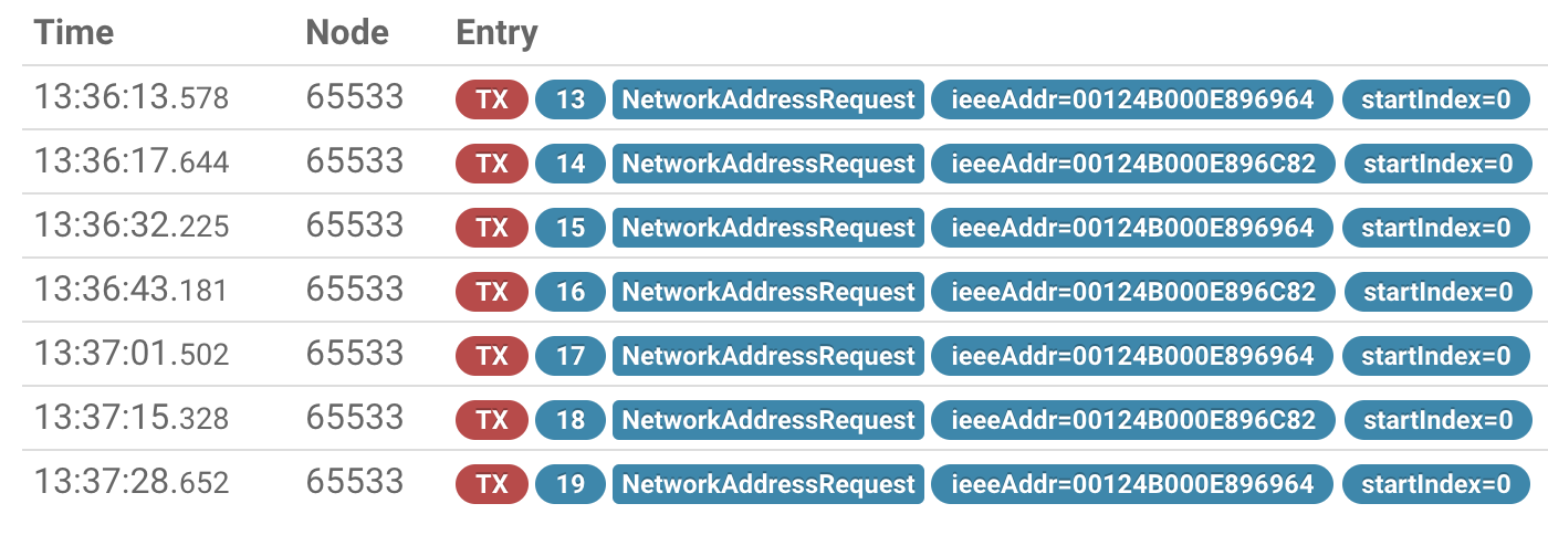

what logging UI is it on the picture? I haven’t seen such in openhab.
It’s the ZigBee log viewer.
