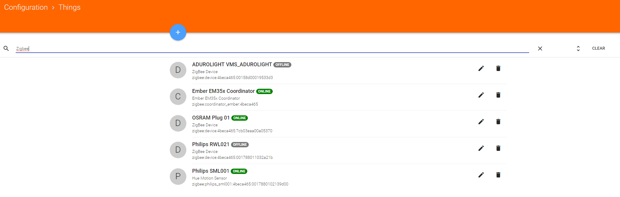

This is a screendump just a few seconds old of my devices and their status in Openhab. Note specific the coordinator is ONLINE. That makes me wonder why the heck the debug logging just stopped on the 14th October without any notice.
Great.. I really hope we can get to the bottom of this quite annoying issue.
