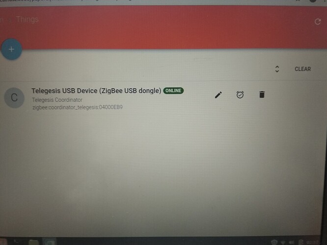

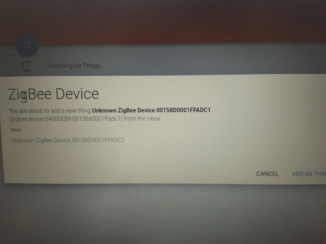

i use OH2 stable 2.5.0 Installed on Linux 11/27/19. The Telegesis USB Dongle (ZigBee) sees the Eurotronic Spirit Thermostat (ZigBee), but defines it as an Unknown device. Help me please. What needs to be done specifically to solve my problem?
Please provide the debug log showing what is happening during the join process and I will have a look.

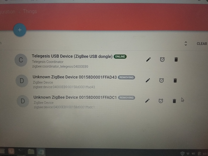

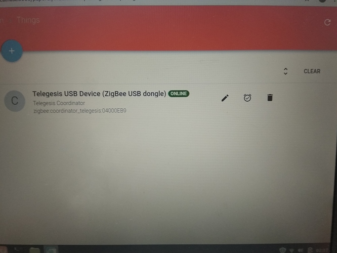

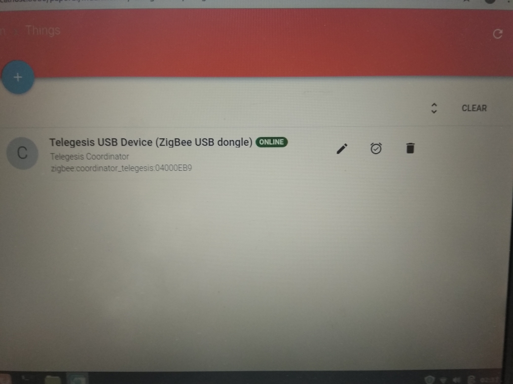

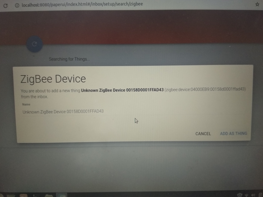

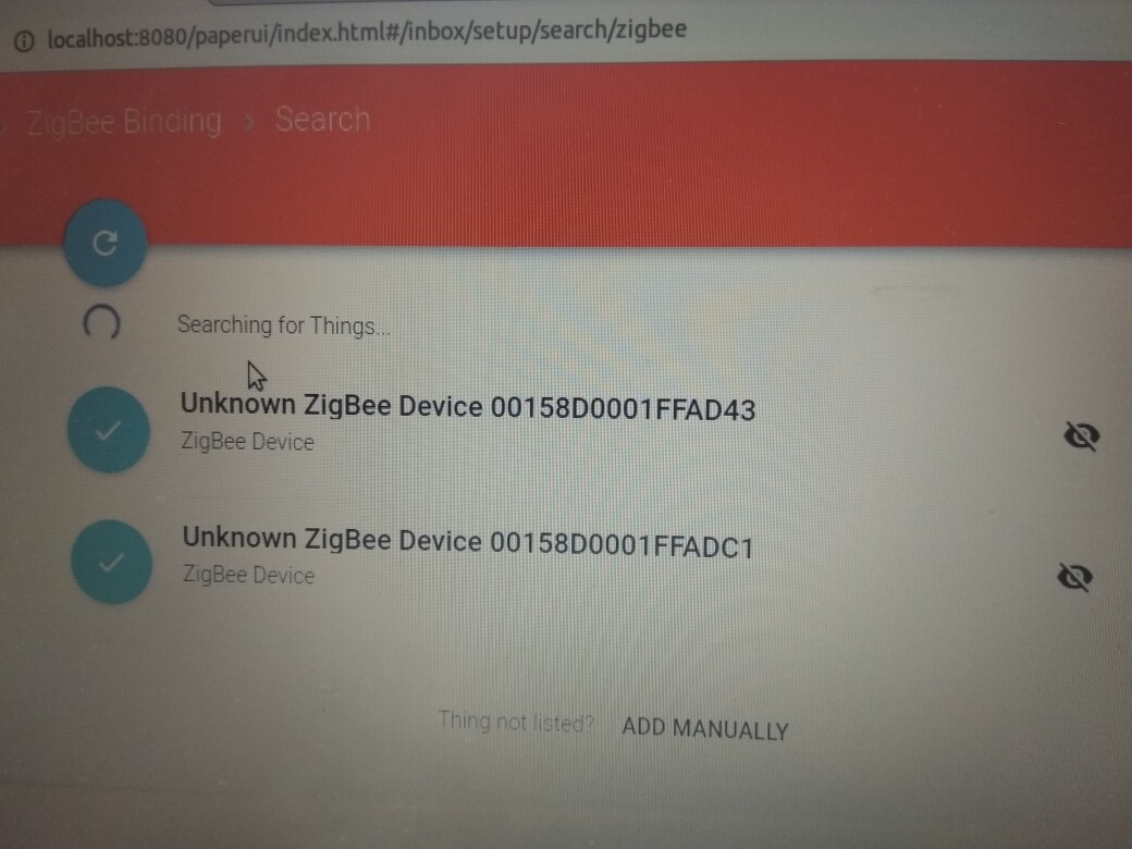

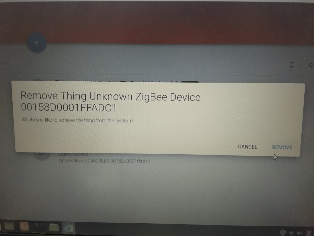

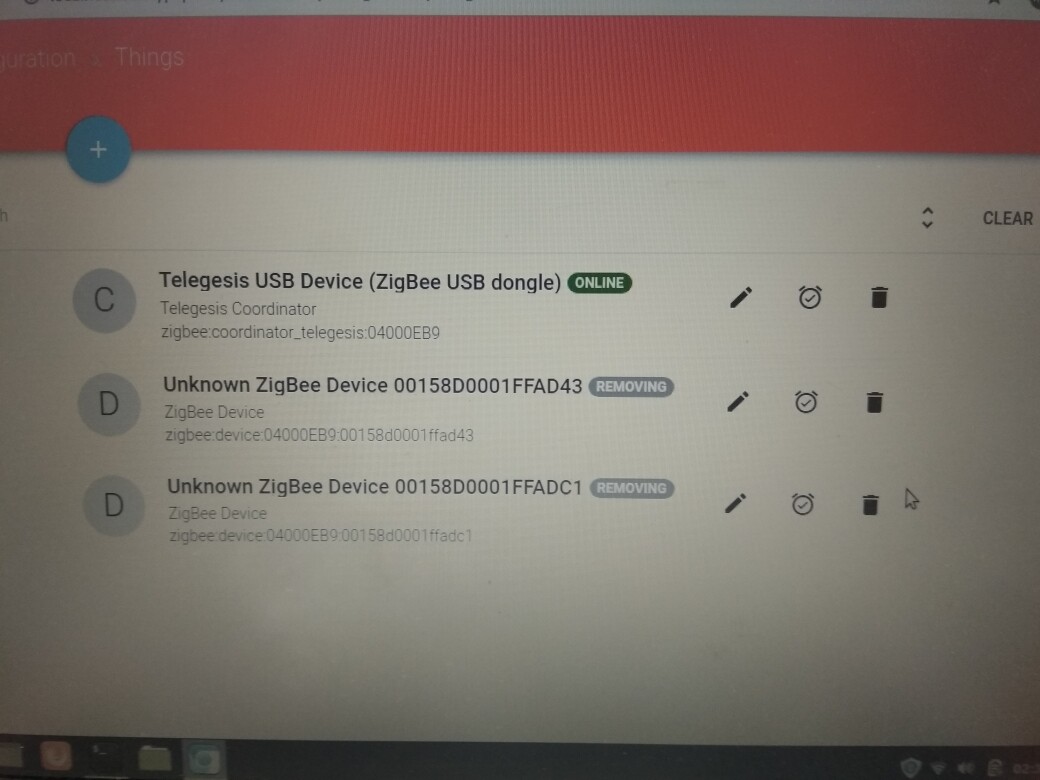

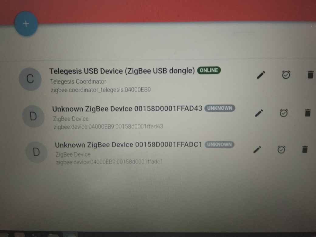

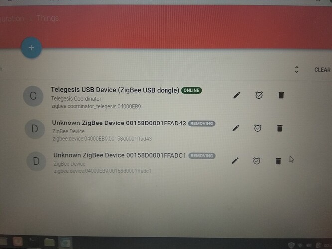

In the attachment, several consecutive pictures of removing SPIRIT and reconnect
