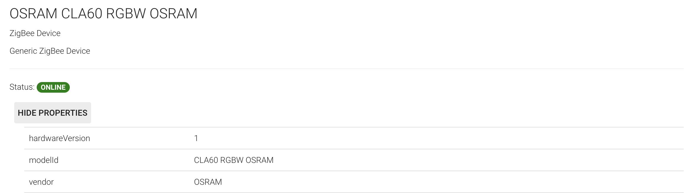

The values here are obviously important. The filename is the name of the OTA file, the vendor and model are values the bulb reports - you can see these in the properties -:
These MUST be the same values for the firmware provider to match the firmware. Note that the thingTypeUid will normally be zigbee:device for ZigBee - unless there is a specific device type (but there are only a few of these which are required to work around manufacturer specific features).

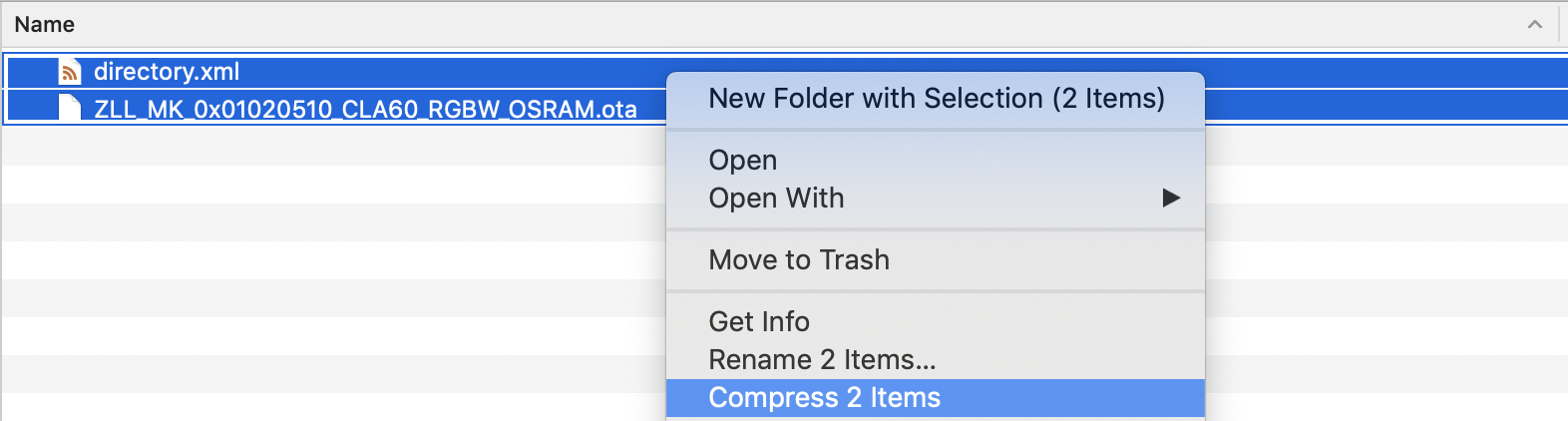

You must then ZIP up the OTA file along with the directory.xml file. You can call the resulting file whatever you like, but it must have the extension fwp. This file must be placed into a folder called userdata\firmware.
It’s worth noting that you can add multiple OTA files into a single FWP file simply by adding more <Directory> entries in the XML and ZIPing up all the OTA files. This allows (for example) all OSRAM firmware files to be distributed in a single FWP file.

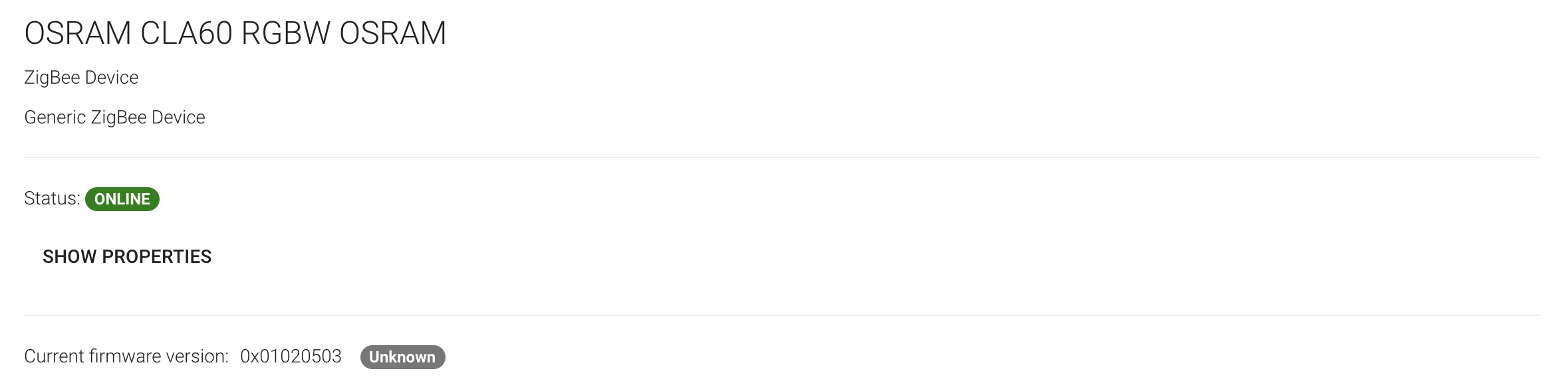

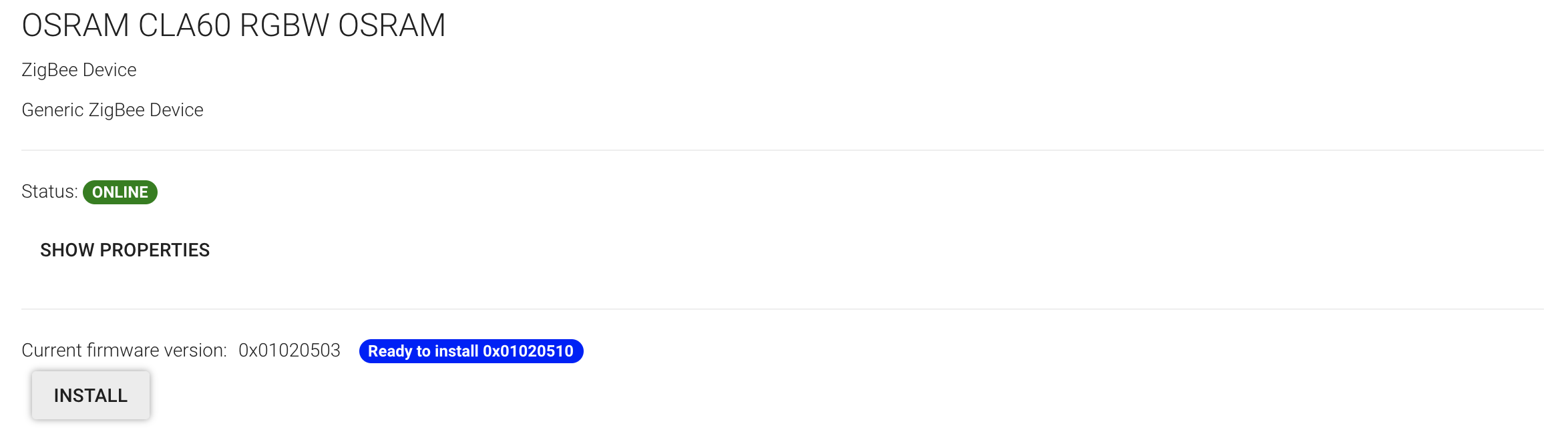

In PaperUI, go to the Thing Configuration. If the firmware file is not in the firmware folder, or the firmware provider isn’t running, or there is no match with the device information, then the firmware state will be UNKNOWN -:
If new firmware is available, you will have the option to install it -:

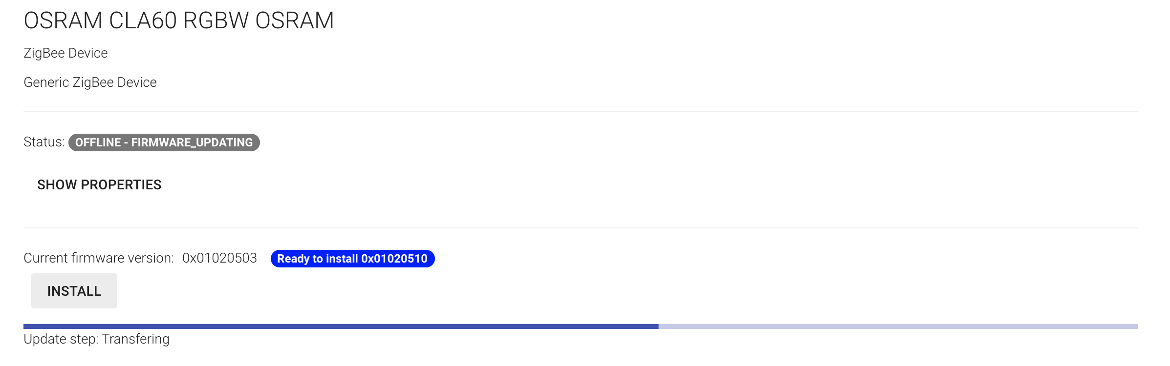

Click the install button and grab a coffee (well, maybe just an expresso - it doesn’t take too long) -:

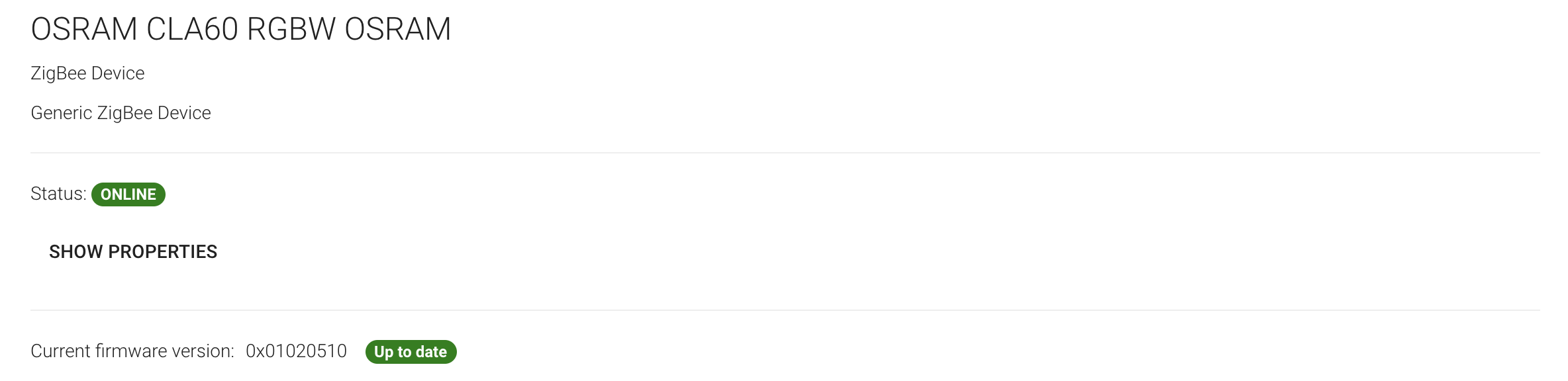

Once the transfer completes, the bulb will restart (it will normally flash) and after maybe 30 to 60 seconds the bulb should come back online in PaperUI -:
You bulbs firmware is now Up to date.

Also, possibly of concern and/or interest… I seem to be getting the option to install that firmware on several other devices, as well. I have an in-wall Zigbee dimmer switch made by Jasco Products, and it’s offering to install the IKEA firmware on it. Hopefully it wouldn’t actually take, but I’m not going to try it and find out.
What does PaperUI say in the properties - that’s what’s important.
I guess the directory is not correctly defined. I will take a look at your file.
PaperUI’s info
