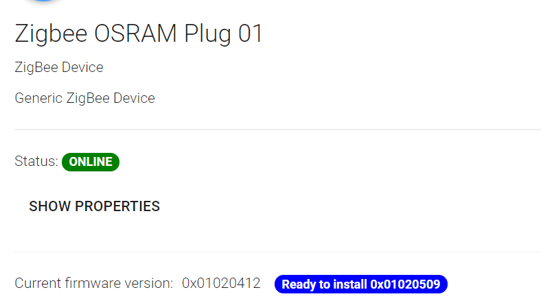

My Binding version is 2.5.5 Release Build, the firmwareproviderjar is the 1.0.2 from above in this thread, coordinator a xbee zstick 2 ZB. The device is a Osram Plug 01.
As per your documentation in this thread I created the xml and and together with the ota file from the ledvance page for the plug 01 I zipped it and put it in the firmware folder.
It is shown also on the UI like in your example above… however Instantly after I click Install I get an “Update failed” on the UI and the above exception in the log.
In the UI it shows:
Anything I could log more to help shed light on it?
best
What about log files for starters? That might help - the error itself is not very useful without knowing what is happening to give it some context :wink:
