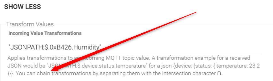

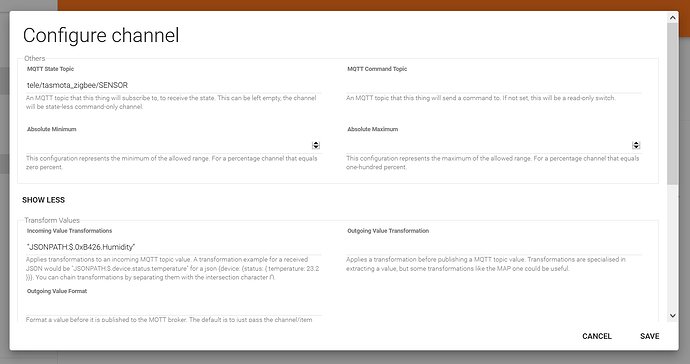

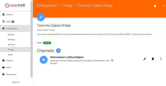

By using the PaperUI I made a thing for the Zigbee2Tasmota bridge. And in these thing I tried to make channels for each value I need. I think the separation has to work with JSONPATH but I don´t know how.
Here´s the log entry:
12:32:34.946 [WARN ] [tt.generic.ChannelStateTransformation] - Transformation service “JSONPATH for pattern $.0xB426.Humidity” not found!
12:32:34.948 [WARN ] [hab.binding.mqtt.generic.ChannelState] - Incoming payload ‘{“ZbReceived”:{“0xB426”:{“Device”:“0xB426”,“Name”:“TempHumWohnzimmer”,“Temperature”:23.54,“Humidity”:58.17,“Endpoint”:1,“LinkQuality”:97}}}’ not supported by type ‘NumberValue’

Your JSONpath is wrong.
Try this:
$.ZbReceived.0xB426.Temperature
etc.
Other devices should have a different address than 0xB426 so you should be able to easily make all the channels you need.

and the right JSONPATH is:
JSONPATH:$.ZbReceived.0xB426.Humidity
As explanation: The mqtt path ends with the word sensor, in the jsonpath every step of {} has to be mentioned. In my case the first step was “ZbReceived”, the second “0xB426” and the last brackets are the values - Humidity or Temperture …
