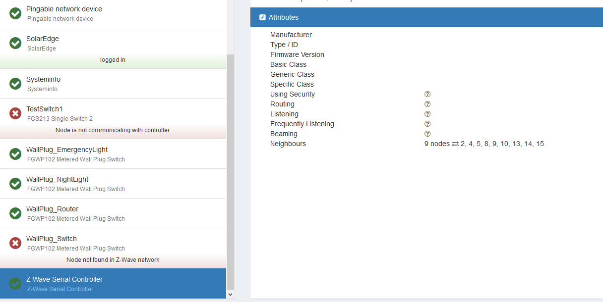

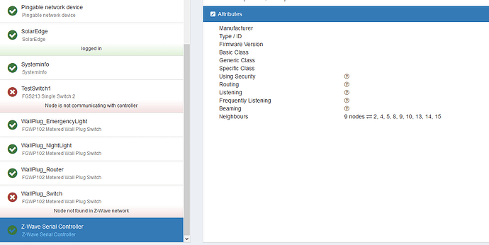

When viewing in HABMIN the ZWAVE controller attributes (using ZME_UZB1) I see empty attributes fields.
Do you see it as well or maybe I have a very old firmware in the UZB which is not supported by OH binding?
My ZWAVE network is working ok.
See HABMIN result:

In case someone has the same dongle, what do you see in HABMIN in this field?
@chris can correct me if I’m wrong but I suspect that attributes field is mainly for devices, not controllers.

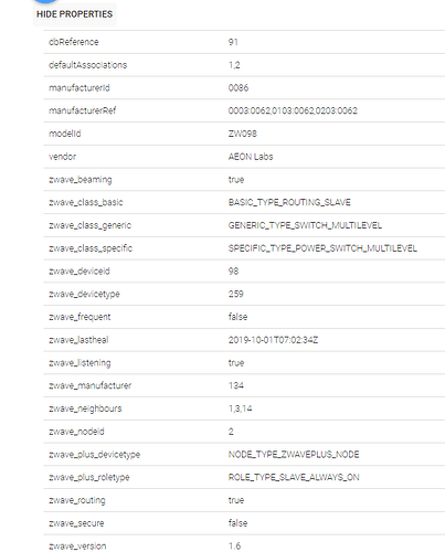

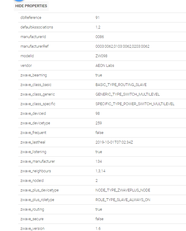

In the PaperUI, navigate to Configuration -> Things -> <Z-Wave device> Click Show Properties. For devices it shows more complete information.
Controller:
Z-Wave light bulb:
