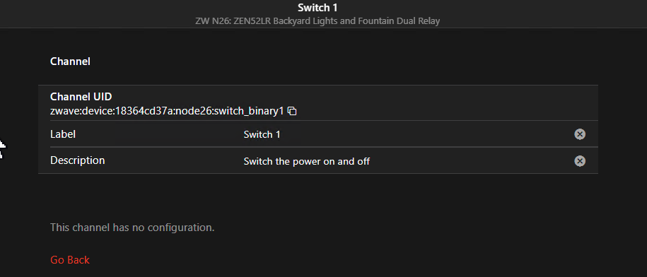

Zoos Zen52 LR Double Relay Page Widget does not respond to relay switch change

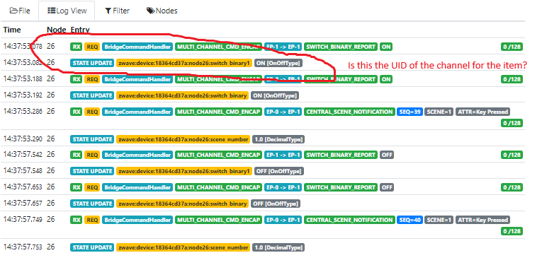

That could be trouble. Two things
  1. Since you are using Debug (Good idea - I was going to suggest it). Post the full unfiltered openhab log for the time period of one switch. I don’t need the event log. I want to see why that EP 1 event is not being reflected in the widget. The DB update should have fixed that. I was going to use the Zwave log viewer here(it color codes thing and only looks at zwave debug).
  2. When you paste log, activate the </> and put log in them.
2025-12-19 11:42:15.172 [DEBUG] [ding.zwave.handler.ZWaveThingHandler] - NODE 26: Got a value event from Z-Wave network, endpoint=1, command class=COMMAND_CLASS_SWITCH_BINARY, value=02025-12-19 11:42:15.283 [DEBUG] [ding.zwave.handler.ZWaveThingHandler] - NODE 26: Got a value event from Z-Wave network, endpoint=0, command class=COMMAND_CLASS_SWITCH_BINARY, value=02025-12-19 11:42:15.392 [DEBUG] [ding.zwave.handler.ZWaveThingHandler] - NODE 26: Got a value event from Z-Wave network, endpoint=0, command class=COMMAND_CLASS_CENTRAL_SCENE, value=1.0
Edit: the scene trouble is that the same number is sent for both on and off;
Edit: Here is a random idea. Unlink the items from the switch channels and relink them to see if that picks up the endpoint
Tried unlinking and linking- no change.
2025-12-19 14:37:53.078 [DEBUG] [WaveSerialHandler$ZWaveReceiveThread] - Receive Message = 01 12 00 A8 00 01 1A 09 60 0D 01 01 25 03 FF FF 00 00 BC A0

Very odd. The log clearly shows endpoint 1 state being changed (as well as the root). When you are on the ui page, you might need to refresh? I wasn’t expecting to see the state update line.
Edit this is what working looks like. Not sure what else to do. Maybe take the controller out of the association groups (except 1)
Edit: This may not work since it should be working now, but back on the scene idea; A rule: when Scene Item updated, run a poll to retrieve the device state. “MyItem.sendCommand (“REFRESH”)” that will ping the device and return the state of all linked channels to items
I refreshed the ui page, no change. By the way I use the same widget in many places, all have working properly up to now.

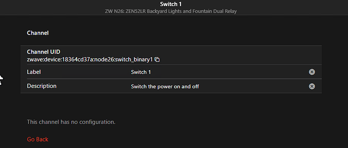

Here’s the UID of switch 1: zwave:device:18364cd37a:node26:switch_binary1 which matches.
Taken from:
I copied the UID from the Relay on the thing page: zwave:device:18364cd37a:node26
